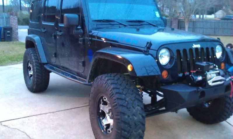

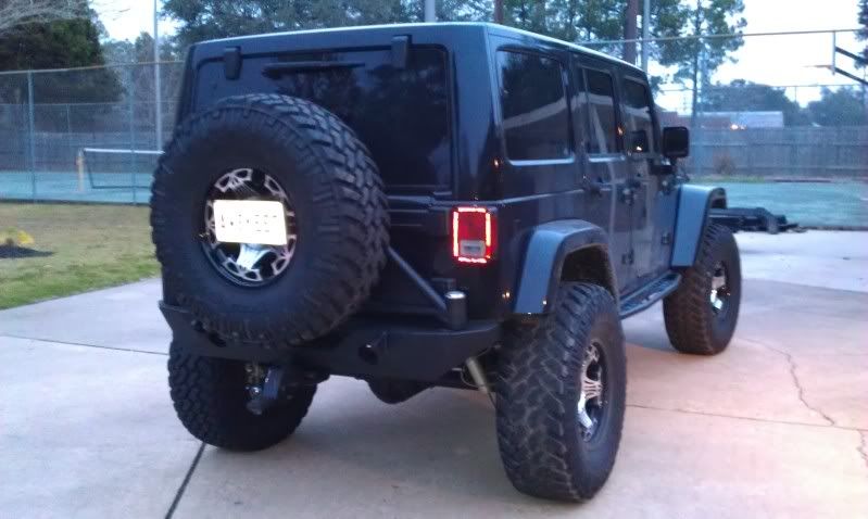

Ok, sooo I finally got finished with the bumpers and rock rails. I went with the PSC brawler light front bumper with skid, rear bumper with tire carrier, and rico steps welded to the stock rubi rails... Only issue encountered was 2 bolts on the skids that the instructions say to put on that prevents the front bumper from being able to be secured to the frame rails. Took those 2 bolts off and went on with a breeze. I am finding that at full turn, I rub on the control arms for the RK 3.5 mid arm flex. Not sure what to do about that. Here's the pics...

Any idea about the rubbing the control arm at full turn? It's the upper (one with the monster bushing)... I suppose there's not much I can do bout it though...
Scott.
The back spacing on your rims is what is causing that. You need 4.5 or less and I bet yours are a little over 4.5. I had the issue on my previous JK swapped the rims to 4.5 and fixed the issue.

How much did you need to cut to get the skid on? Do you have pics during the install?

Originally Posted by peanut View Post
Th9e back spacing on your rims is what is causing that. You need 4.5 or less and I bet yours are a little over 4.5. I had the issue on my previous JK swapped the rims to 4.5 and fixed the issue.
Good luck!
Nope its have those wheels they have 4.5 back spacing I turned my steering bumps out alot and getting ready to buy 1. 5 inch spacers so i can screw it back in to get full turn radius
Your not copying my rig are you?
LOL! Not at all...just the rims... I got blue stickers on mine...
I just checked the air pressure they had in the tire..right at 35 lbs. Aired down to 28 and got my caster angle to a little better than 5 degrees. Seemed to help some. Haven't got it to rub since. Nice looking jk btw!!
I cut the crush panel thing off under the bumper...that's all. There's 2 screws they tell you to tighten during the install that hold the skid to the psc bumper (8 total I think). The 2 by the frame bolts cause the frame not to be able to seat enough to screw the frame bolts on... kinda hard to explain, but you'll see what I mean when installing....
