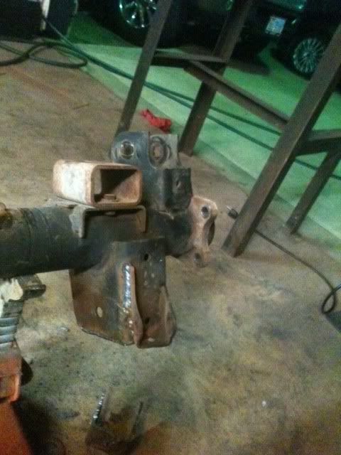

Ive been thinking about doing this as well. Talked with one of the guys in my group and he said you can pick up a set for around $25. Im thinking you could make them work with out to much complication.

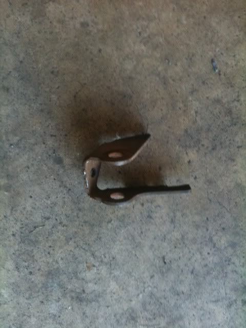

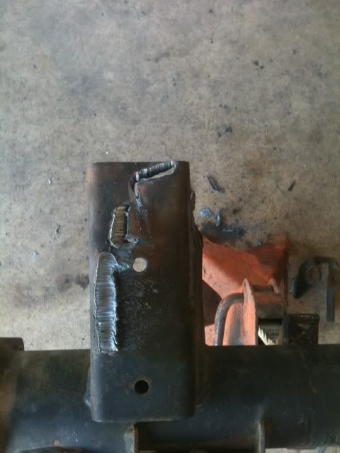

Also, Im sure you have already thought of this but in the rear you can chop the lower shock mount and gain about 2" of ground clearance while allowing the rear axle to drop out some more. I did this while doing my gear install a few months ago and was able to chop the stock shock mounts off, shorten the bracket up and re weld the shock mount back on. Like this....

Hadn't really put much thought into the rear but I do hate how far the stock mounts hang down. I like what you did, are you concerned about limiting up travel at all? I'm guessing in the stock position the shock can't compress entirely anyway?
