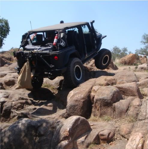

Originally Posted by Topgun863 View Post
How do the Fox's flex?? are they pretty good on rough terrain at speed? How often (if ever) do you find yourself adjusting them say for different terrain?
They flex great - see pic below. I did some pre-running at big bend last year and they are great at speed. But I didn't put them to a long test, just a few minutes at a time. I run them at (scale 1 - 10) 7 on the street and 4 off road. Look at the driver side rear tire in the pic to see the Fox flex!
Wow that's pretty good articulation. I notice your sig says you have coilovers, did you have the regular adjustable remote resi's before? or are you just running the coilovers in the front now?

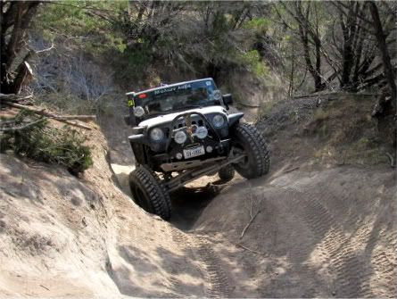

I have the 2.5 adj res Kings and you can get them cheaper if you shop around! I found the cheapest advertised price at EVO they list the non adj Kings for 680 pr add 200 for the adjusters and my buddy at 4wheel parts beat there price!
I just got the King shocks installed last weekend along with the RK lift so not much feed back yet I will say the on road ride is a lot better! Hopefully this weekend I can get out and try them off road after I fix a track bar issue hitting the AFE exhaust pipe in the rear limiting up travel. If you do go with the Kings cycle your suspension with the springs out and ck for clearance and set your bump stops I had to grind down some of the shock tower behind and along side the front shocks and modify the RK rear track bar bracket for rear shock clearance. You should be OK with the Poly rear track bar mount but but ck the fronts just to be safe!
I went with the 3-5" lift Kings and they measure 17.5" collapsed and 27.5 extended I'm getting the full 10" of travel except for the RF I had to add a 3/4" bump spacer to keep the front RK track bar mount from hitting the frame!
Here's a pic of the rear close to bottom out if you like playing on the rocks I would highly recomend relocating the rear res to a safer place...
