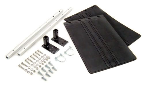

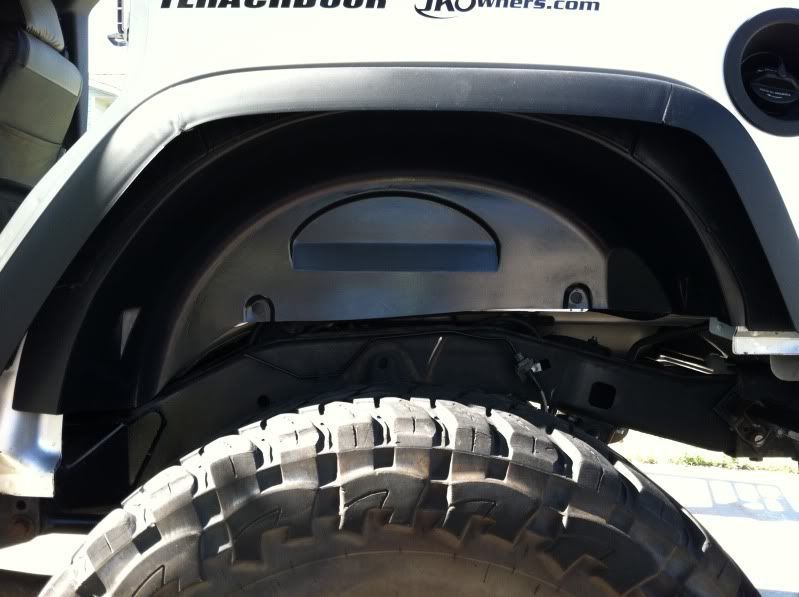

I have the TeraFlex mud flaps. I like 'em and they work well.
I utilized the factory rear bumper bolts to attach them. Then the only drilling was to make the 2 of the 4 holes in the TF brack bigger. Bolted right up, easy as can be.
You can see the bracket attachment in the lower right of this pic:
Here is what thier kit looks like:
Although, this pic does not show an additional bar/plate that mounts to the outside of the flap. Which then sandwhiches the rubber. Be sure the kit has that part if ya order these.
