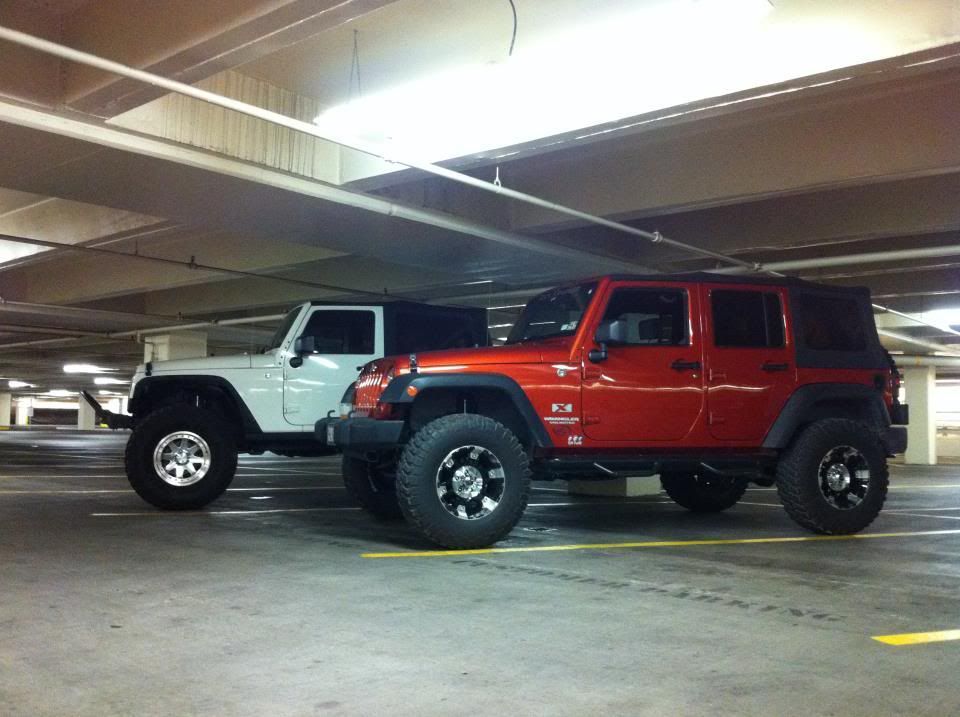

Here are some pictures of my JK with the setup I mentioned:
This is the most recent with a flare posing on the front:
This is without any flares. The orange Jeep has the 2.5" Stock Mod with 35/12.50R17 BFG KM2s:
Here's another view:
Here it is all flexed out on a forklift. LOL
My buddy Will has the 2.5" Max Travel on his 2 door as well and runs it with 35" Toyos. (nc_fjizzle)
