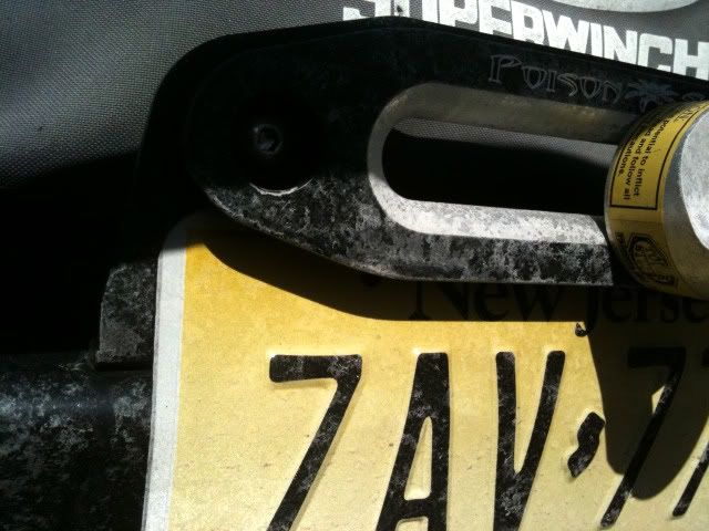

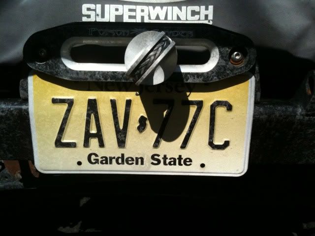

No need to buy a bracket or fairlead mount. Stick the plate between the fairlead and the mounting plate on the bottom. Just be sure not to push it up so far that the winch rope or wire rubs on it.
Pics:

not a bad idea but I know for a fact this wouldn't fly up here as they even give you shit for having license plate covers that cover the top where the state is written.

Good point E - I didn't consider that.

I like this idea, do u have pics further away? Thanks for the responses guys!

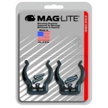

just use these. Mounts right to the rollers on the fair lead. Mine has been on since november through colorado blizzards and still on there.
I don't have any shots of the whole front, and it's pouring outside right now. I'll put some up tomorrow night after work - weather permitting.
