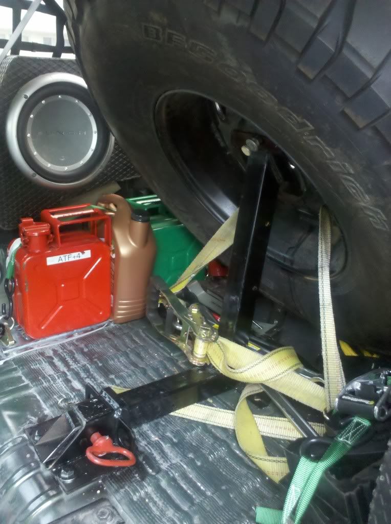

I made mine.
Took a 2" reciever hitch and sandwiched it with another plate dead middle of the cargo area against the back of the seats. Then I made a L shaped mount out of 2" steel that plugs into it with a angled plate for the rim. The rim is bolted to it and then a ratchet strap keeps it from lateral movement.
Takes up less space and cost me like $50, that and I can pull the entire thing just leaving the reciever in under a min leaving a free cargo area.

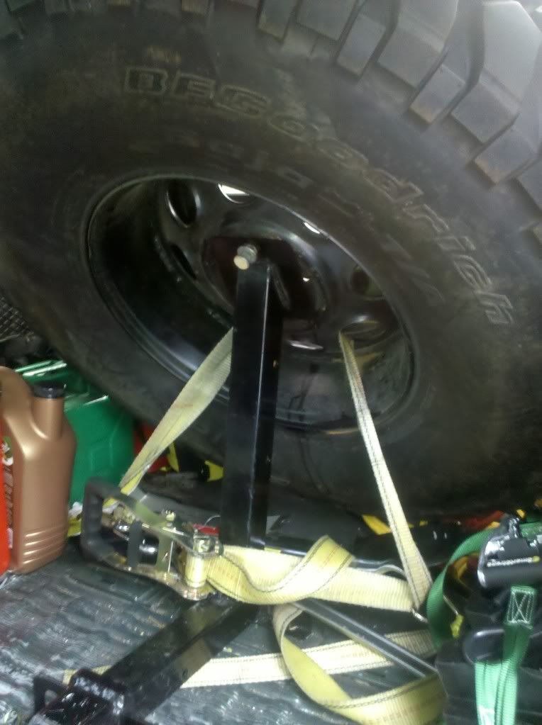

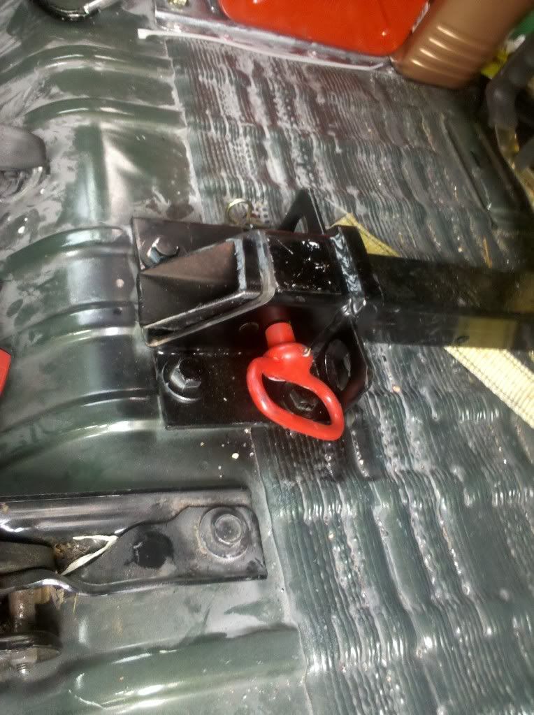

$16 2" receiver from harbor fright, some medium wall 2" tube and some 1/8" plate underneath that sandwiches the floor. The "holder" has 6" "outriggers" on ither side to keep it from wobbling. If I did it again I would:
add 2 more bolts to the plate to wheel
extend out the "outrigger" plate to 1' on each side
weld some nuts or thread the ends to allow a bolt/knob on each outrigger end to be able to "preload" the mount and get rid of wobbles/squeeks
or I would just add a couple footman loops and latches that would do the same.
But right now it works great so no need to "fix" it
