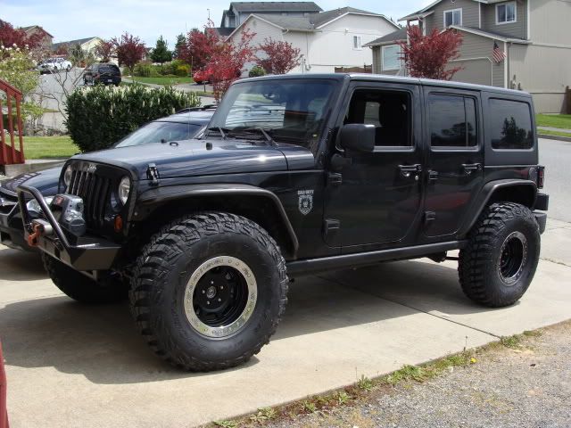

Just got back from Discount Tire. They were able to balance them without a "shitton" of weights.
Boosted is offline
post #16 of 22 Old 05-14-2011, 06:54 PM
Mr.RonGilbert's Avatar
Location: Houston
Posts: 9,140
Looks good Boosted. Did they say anything about the beadlocks or did you just roll it in and say "balance please"?
All but one of mine pretty much balanced. I had one that would not.... even with a shitton of weight. They wrote "spare" on it and I said something like... "horse shit" I spent too much money on that to use it only as a spare. I will keep working on it and get it dialed in eventually. I may try taking it to a different place to get balanced.
Mr.RonGilbert is offline
post #17 of 22 Old 05-14-2011, 07:46 PM Thread Starter
Boosted's Avatar
Join Date: Apr 2011
Location: PNW
Posts: 651
Nope, no hassles from them. I actually had them mounted on the rig and drove there. Told them I wanted the tires siped and balance and they said ok.
