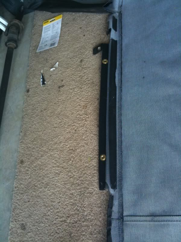

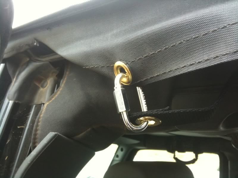

Chuck Bullitt's Avatar
Location: Providence Village, TX
Posts: 781
Originally Posted by EODtech View Post
Ha Ha That's what I've been doing recently. Since its cleared up today, I may just reinstall the top. I'm kinda needing to since the right rear side velcro is not catching.
I don't even use the velcro anymore....kept coming loose from the rear passenger side.
I punched a couple of grommets on each side through the velcro section over the rear doors, did the same to some 1" nylon strap I picked up from Walmart's camping section, and strap it in the back like Bestop did in the front.
Chuck
Chuck,
How do you attach the strap to the grommets? I'm loving this idea and I'll be heading to Walmart this weekend.
Thanks
JD
I used chain link connectors, but zip ties would work too. Added more pics:
One strap is over the sound bar, so you can't see it.
Chuck
2009 JK Unlimited X, mostly stock with a K&N filter.
