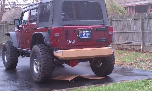

I just made one out of 3/16 th. It's still in the making. Just started to make the tire carrier. Ordered a draw latch. And ordered a spindle from A to Z fab.
I grinded a line to make the bends than MIG welded the seams that I bent
This is a test fit. Since have welded on shackle tabs and started on carrier.
Cost me only 80 bucks. Got steel free from work. Just had to order spindle and latch.
Sent from a Android on Tapatalk..

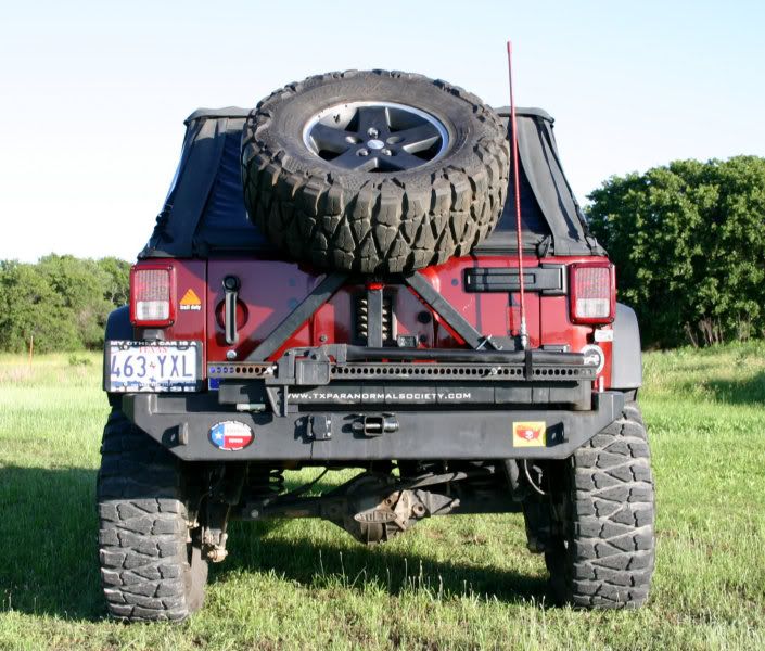

that carrier design looks exactly like Rock Hard's
strong & simple.

Those T handles work great but they rattle. That would drive me crazy.
Here is a good draw latch. I got the #3 for my build. Only took 2 days to receive it ordering through this place.

Also anyone building a bumper I recommend making one out of cardboard first to get a idea what it is going to look like and to get your measurements straight.
