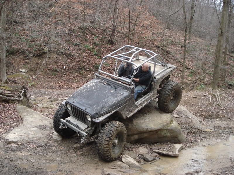

i've had both
kingpin hp60:
and a balljoint HP60
the balljoint axle DEFINITELY turns better
2k2wranglerx is offline

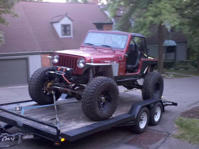

post #13 of 15 Old 11-29-2010, 11:18 PM Thread Starter
andrelopez99's Avatar
Location: Uvalde, TX
Posts: 2,364
i've had both
kingpin hp60:
What axle is in the second pic..
andrelopez99 is offline
post #14 of 15 Old 11-29-2010, 11:19 PM
2k2wranglerx's Avatar
Location: Pittsburgh, pa
Posts: 10,277
late model superduty axle (like out of an 01), stock knuckles, brakes redrilled for 8x6.5 to match the 14 bolt rear
