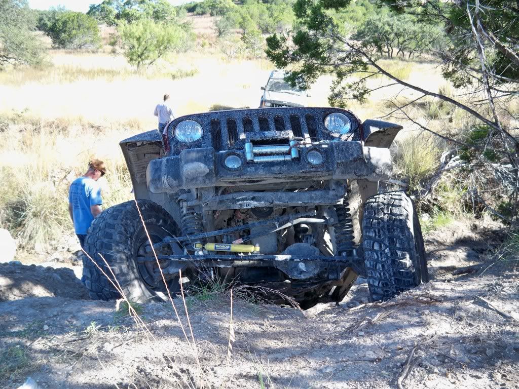

If everything is tight and adjusted properly you don't really need an expensive SS. The better money would be to move the SS up out of the way. This will prevent your SS from trail damage. It happens easily if you wheel and is only $45 to get it up and out of the way if you use the Jeepswag.com part from Woods. Next will be ram assist for my steering issues.
