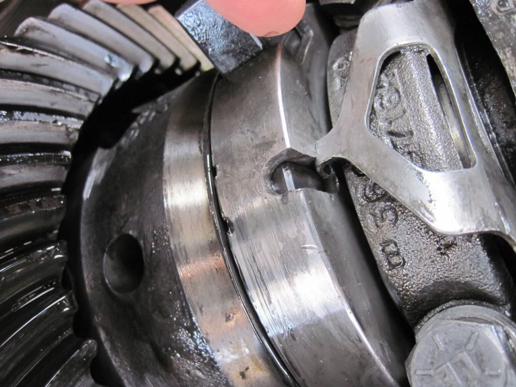

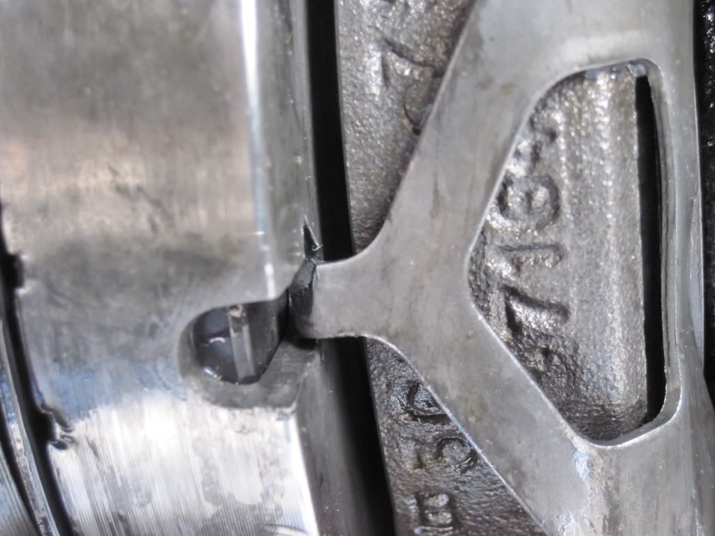

well besides my leaking pinion seal and bad bearings I think I found out why my locker light is blinking.
Anyone know if they sell the parts on the right separately? You can see the groove that is cut into the metal that should not be there and the tab doing it is worn.
I'm thinking I am screwed because I've heard most of the parts for the locker they dont sell separately and I dont even see it in parts diagram

Just bend the tab so it hits in a new spot. All that bracket does is the keep the magnet from spinning. When I first opened mine up that little ear thing was barely in the slot...so I took a screwdriver and just bent it over. While your in there you might want to check to see if your plunger is in the right palce.
the magnet stops but that little ear is worn through half way and I dont know now much longer it will last
Lockers been fine for 60K+ miles no blinking at all till now, I'm 99% sure plunger is it correctly.

Tim,
Not really sure how easy it is to take just that part out, but it would be really simple to fix it. Just cut it down and weld on a new tip and grind it smooth....
You could even do it with everything put together if you were careful with the slag and heat of the weld....

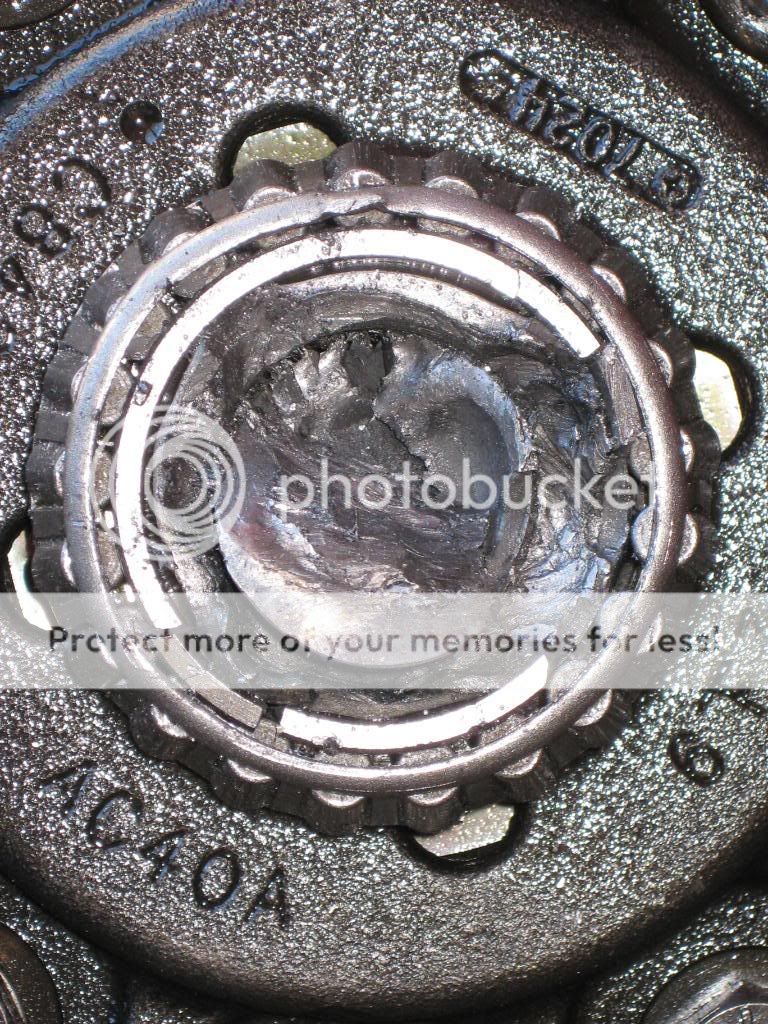

post #17 of 17 Old 04-27-2010, 08:08 PM
bodyguy's Avatar
Location: Shit Creek, Texas
Posts: 4,013
Here is what it looks like, you should be able to use the rest of it
