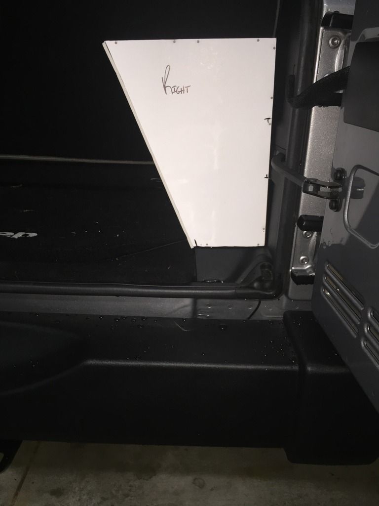

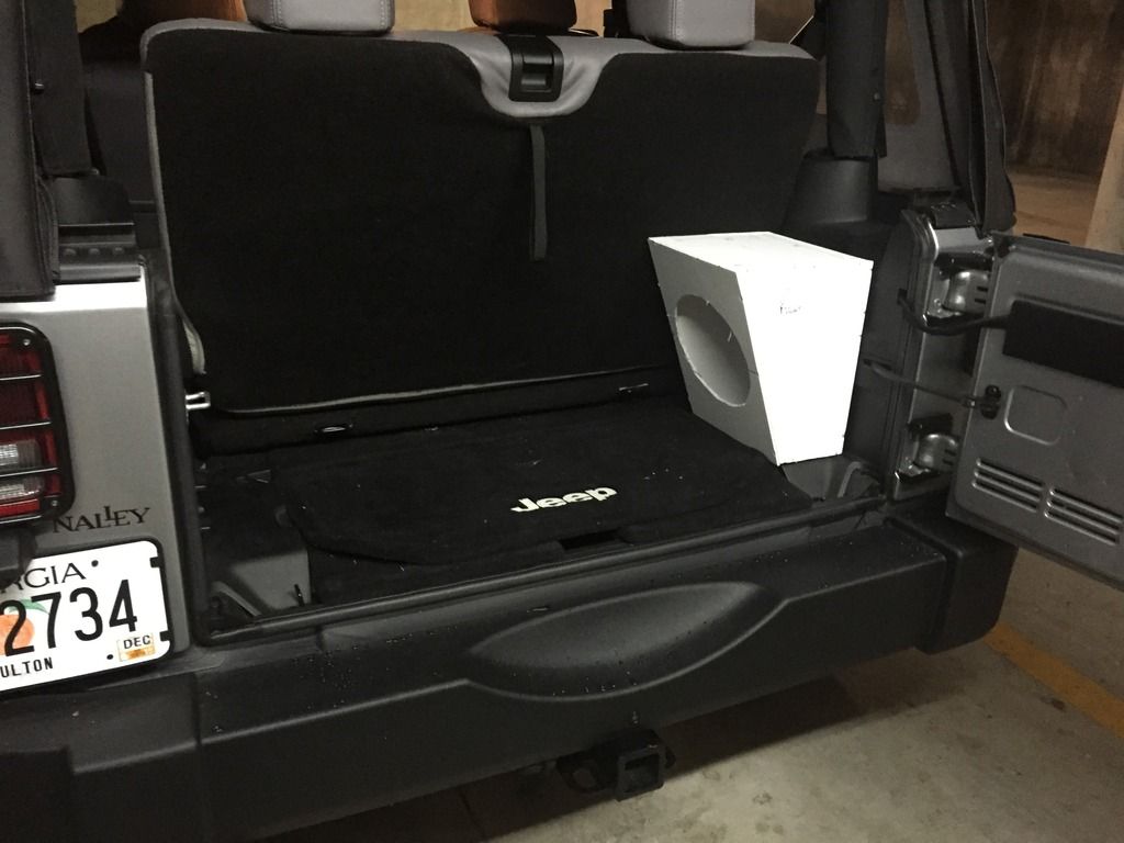

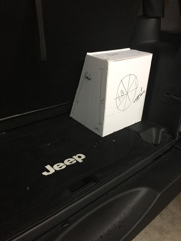

I mocked up a box to test fit it, and looked at 2 different options. Here's the first:
Slightly angled down, to protect from rain (kind of), to downfire into the cab, and to be kind of less seen. There is an inch on each side between the edge of the speaker cutout and the box. Think this is enough?
needs to be brought in just a little to keep from interfering with the lid. my goal was to leave just enough room to lift up and slide the lid out. It doesn't need to open completely vertical.

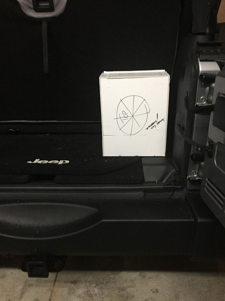

Then I thought, why not just flip it around, angle the wedge side toward the seat, and have the sub fire toward the tailgate. The first option would require the removal of the sub (which i plan on making easy) in order to fold the seat. This method allows the box to stay when the seat is folded. I could also make it closer to the tailgate, which would make it harder to steal once I secure the box. I would trim the trunk lid down to where the sub overlaps, and stick the amp under the part of the lid that doesnt open (assuming I can keep it cool enough down there). I could also sneak it in the dead space between the right side of the box and the wheel wheel, and build a cover so you can't access it from the top. I would also build the box out a little more in this case.
Edit: I would probably raise the box in this configuration, and have it downfire, instead of toward the tailgate.

Before you decide on a box size, you need to run the T/S parameters of the woofer through a box program and make sure it can perform. As for your question, with 3/4" MDF having 1" along the edge of the box will be enough. Just use a good adhesive like PL Polyurethane construction adhesive. This will make the bond stronger than the MDF itself. An 8" woofer is a good choice, but don't over look multiple smaller woofers like the Tang Band W6-1139SIF. You can run 3 of them in 0.39 cu. ft. and get higher SPL than a single 8" woofer.

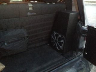

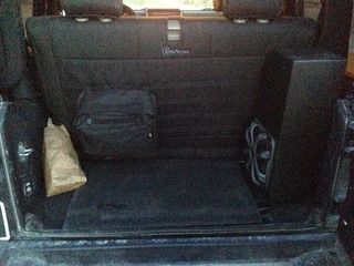

I wanted to be able to fold the rear seat down, so I built this. I don't have any other pictures, but part of the box goes down into the storage compartment area to gain some more air space.

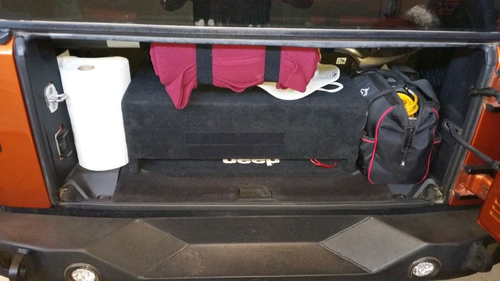

I thought I had pictures on here somewhere, but I can't find em, here is what my current setup looks like.
I still have my cubby packed full of tools.

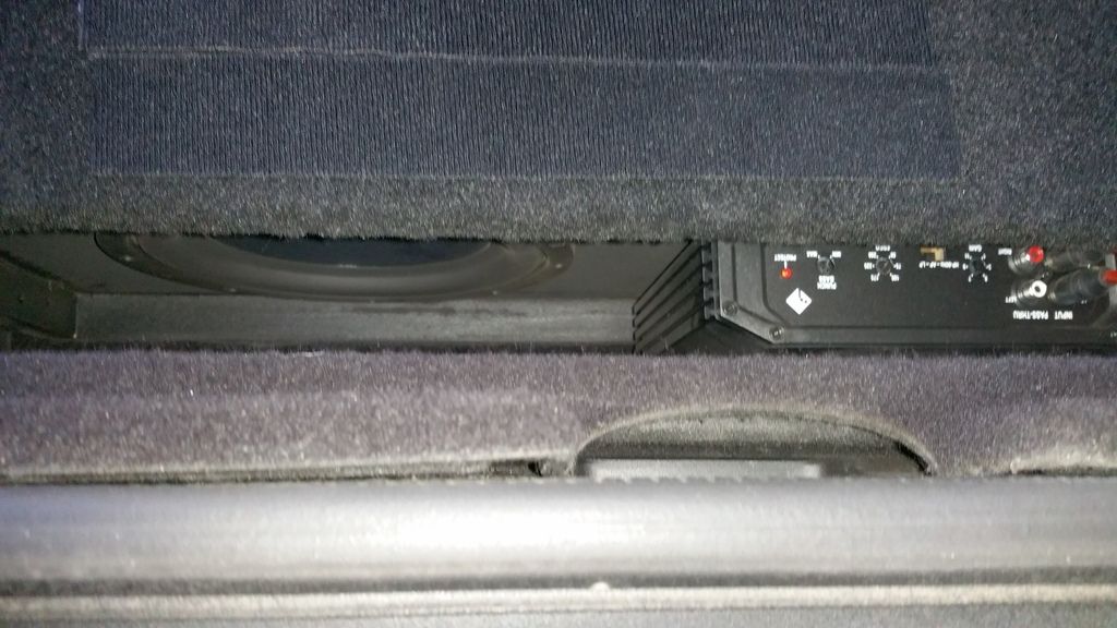

Here's what I have installed in mine. I don't know the specifics of the box, because I bought it from the original owner. I absolutely love it though. Just wanted to help give you another idea if needed.
