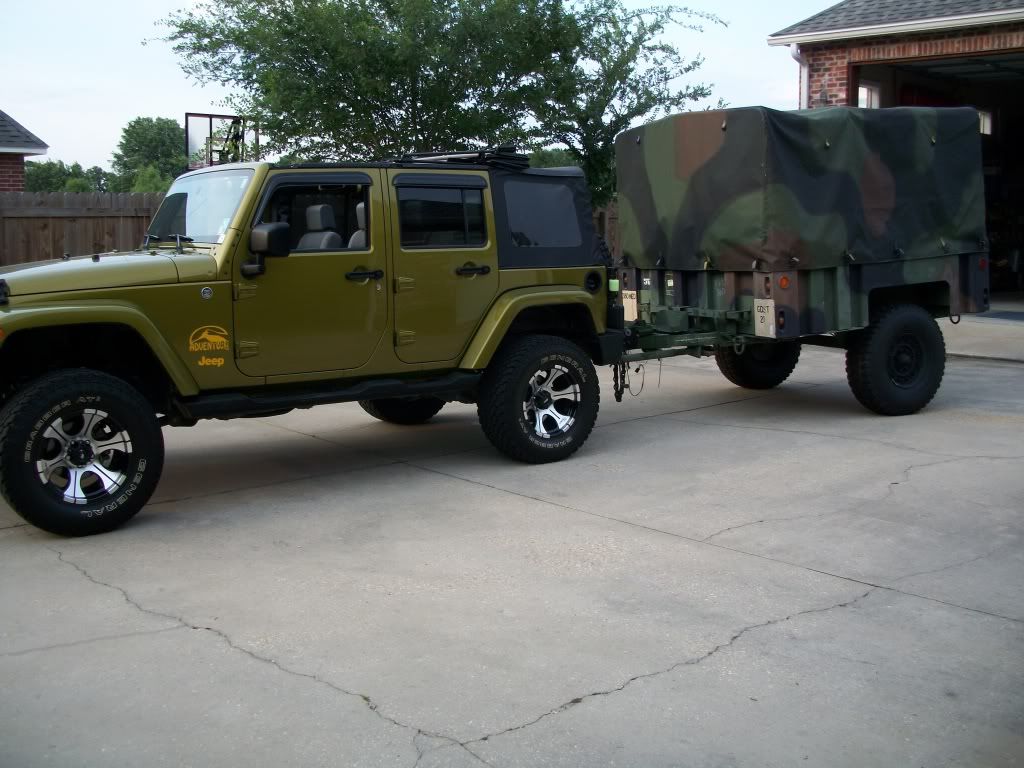

I'm thinking about another option as well. Buying an M1101 Humvee trailer and making it a combo Camping Trailer with a rooftop tent and motorcycle hauler.

Only issue with the military trailer is the height and getting a heavy bike up the ramp. Also is that long enough to fit the Harley? I'd lean towards the enclosed trailer. Bike stays clean and out of sight. Also they come in handy for large items you may buy, couch, TV, etc.

The bike will fit in the back with the tailgate down. I have a concern about loading the Harley but I think with the proper setup it wouldn't be a problem.
I was also thinking of using the enclosed trailer and making it into a camper for wheeling trips to offroad parks and just setting up in the parking lot. A lot of them have hookups and I could mount a rooftop A/C unit.

The M1101/M1102 trailers do sit pretty high but a smaller/lighter set of tires and wheels would help lower it and shed some weight. 1 benefit you'll get from the M1101/1102 trailer is the surge brakes. The landscape trailer won't have brakes. The M1101/1102 trailers do have plenty of tie down loops in them on the floor.
I wouldn't want to load a Harley in an M1101/1102 with it sitting as high as they do and lack of breakover angle on the Harley. You'd need one hell of a set of long ramps or a loading dock to get the bike in.

I work on military equipment full time and those M1101 trailers are pretty sweet but they are tall as hell. I for one wouldn't want to use it to tow a motorcycle with. Not only would loading and unloading be a real chore, but that puts a lot of weight up really high.
