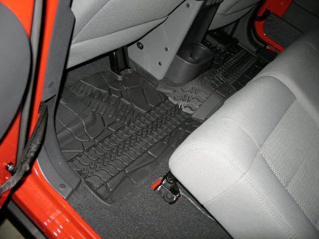

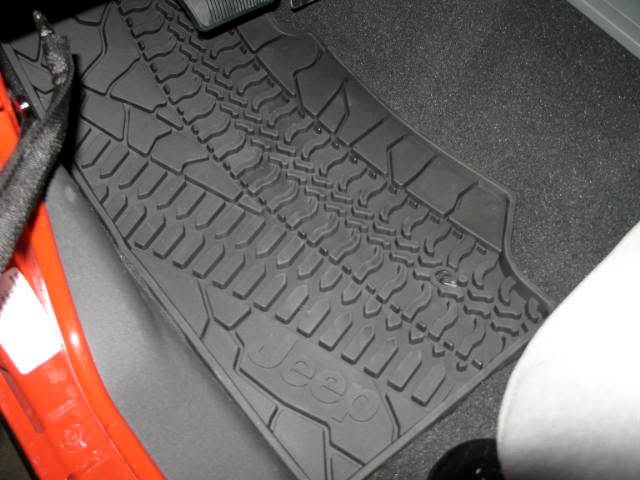

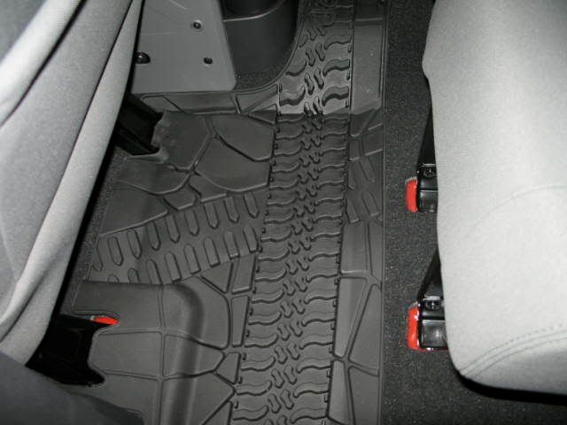

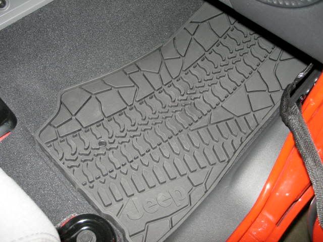

Then I threw in the Mopar Floor Mats

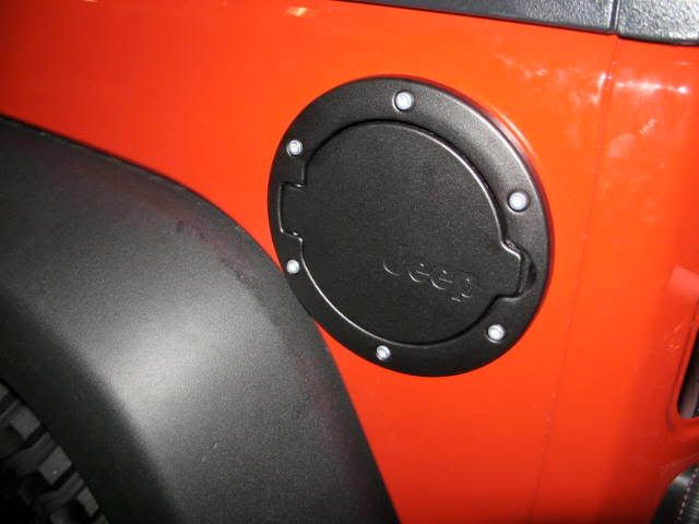

Then I installed the Mopar Fuel door. I like the look better then an open Fuel Cap

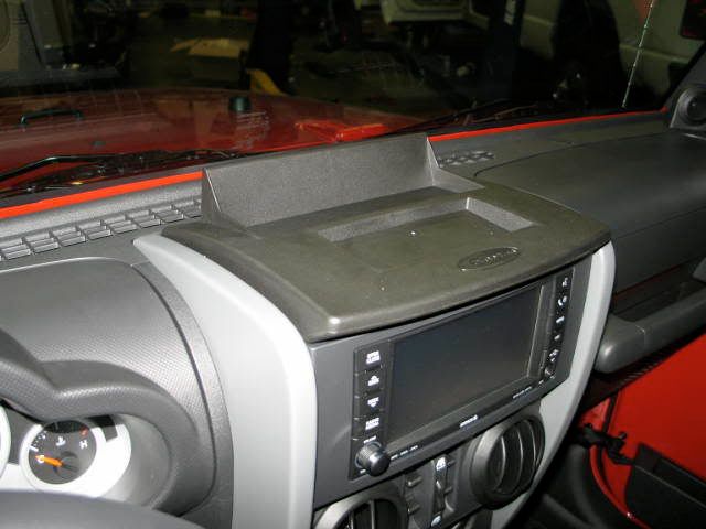

Then came the Daystar Dash Pad

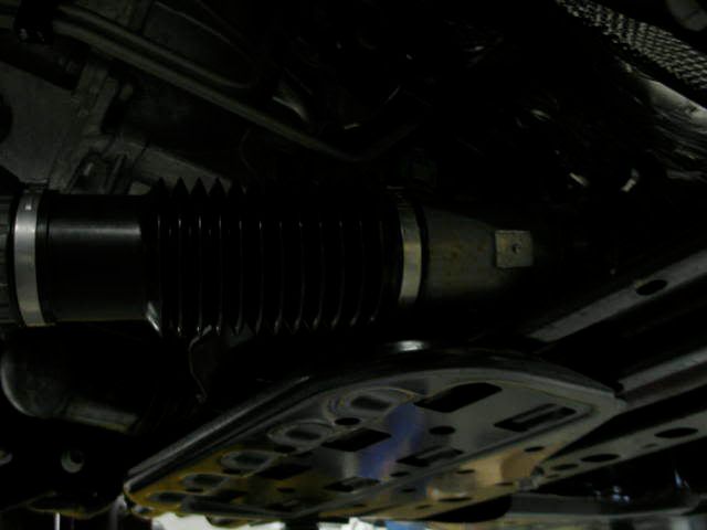

Next as parts arrived I could actually work on I started prepping them. Riddler Diff covers were cleaned and painted as well as the install of the Optima Battery
JE Reel 1310 Driveshafts also arrived

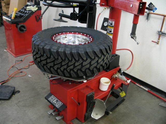

Wheels and Tires are here and were mounted

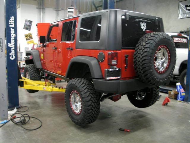

The Full Traction 4" Ultimate lift finally showed up. It was time t get down to business. This lift fit better then ANY other lift I have ever installed. The brackets mounted nice, the holes lined up for bolts. Very easy lift to install. I have two issues with this lift. One my front Trac Bar hits my riddler Diff cover. This is the thinest of Diff covers and I now have my arms 1/4" shorter then stock to try and get it to clear. It still rubs after much grinding on the diff as well. You will see pics of that later. The other is this lift is supposed to sit level. It sits about 3/4" lower in the front. Enough that I have now put 3/4" spacers in the front as otherwise my bumper would be draggin the ground when it gets installed with my winch.

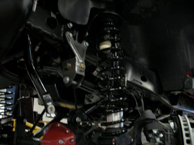

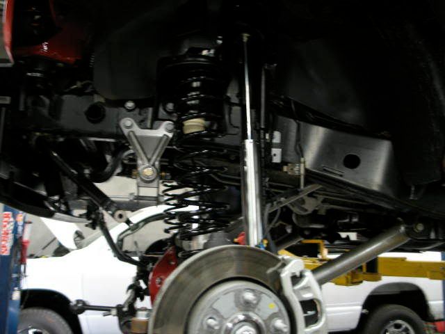

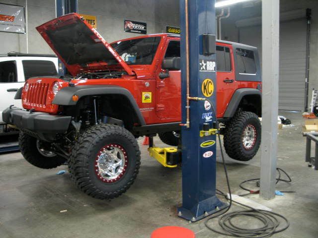

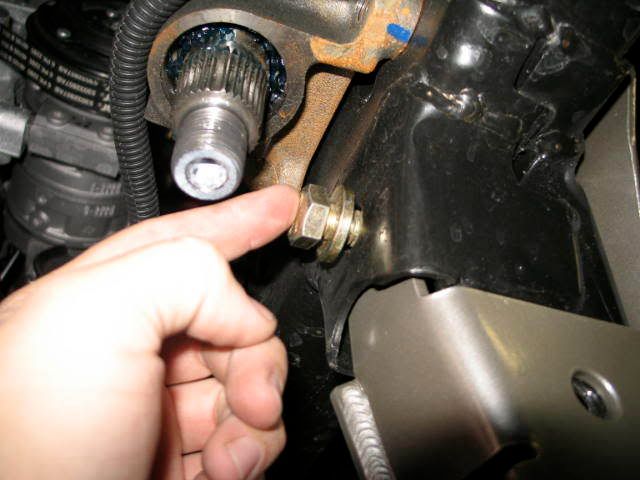

This group of pics shows the installation of the front end suspension components. This kit went on very very nice.

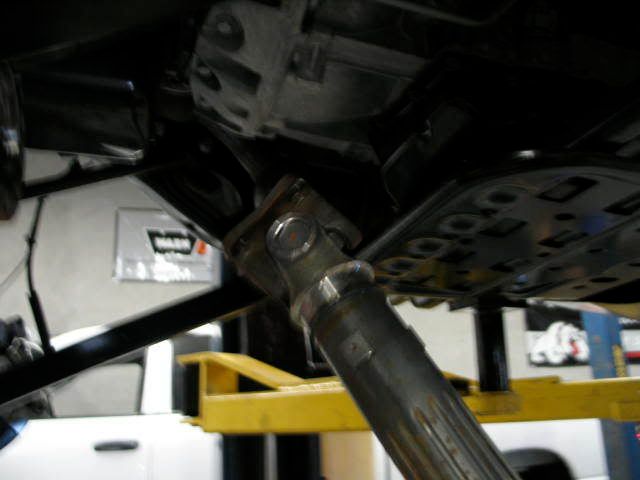

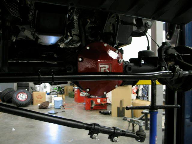

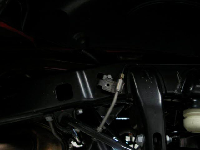

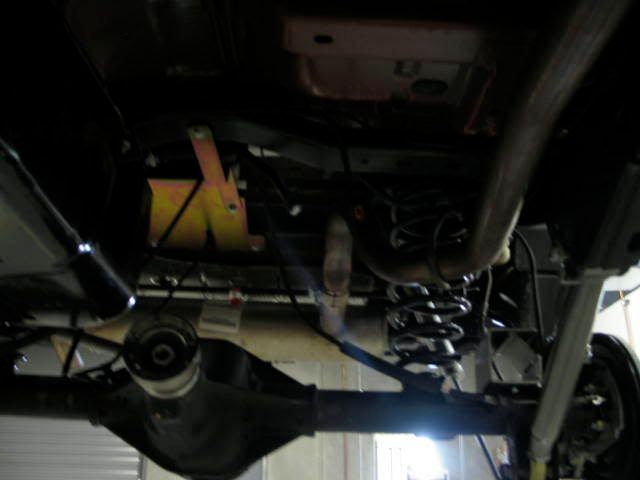

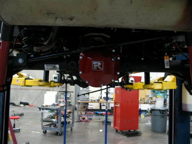

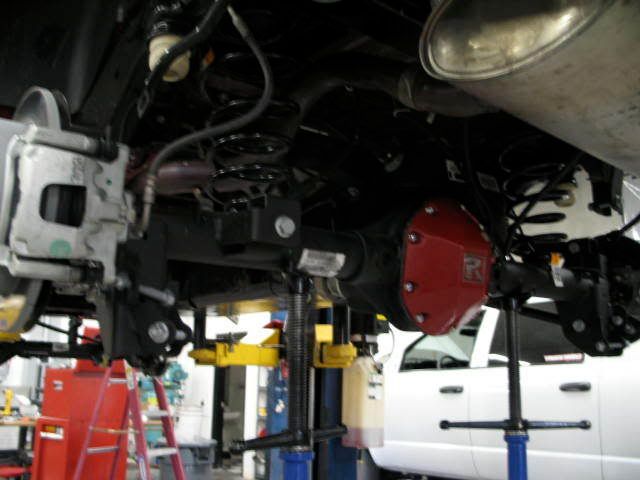

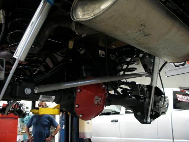

These pics show the installation of the Rear Diff cover, Kilby relcation bracket, Trac bar and rear end suspension components as well as getting ready to set it on the ground to tighten up all the arms.

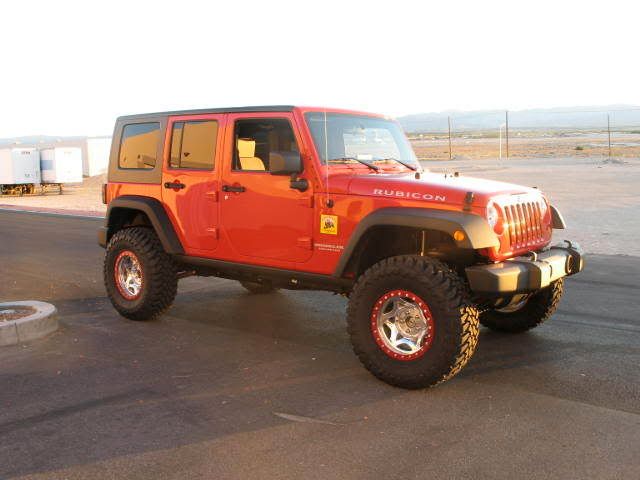

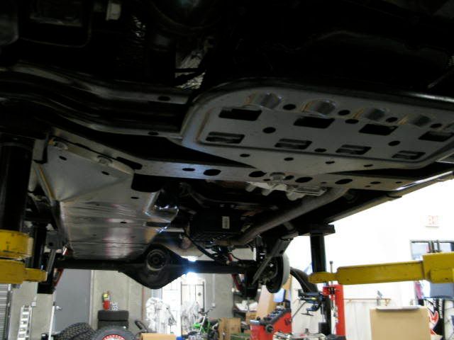

This concluded getting this beast lifted and back on to the ground. The finl product looked like this.

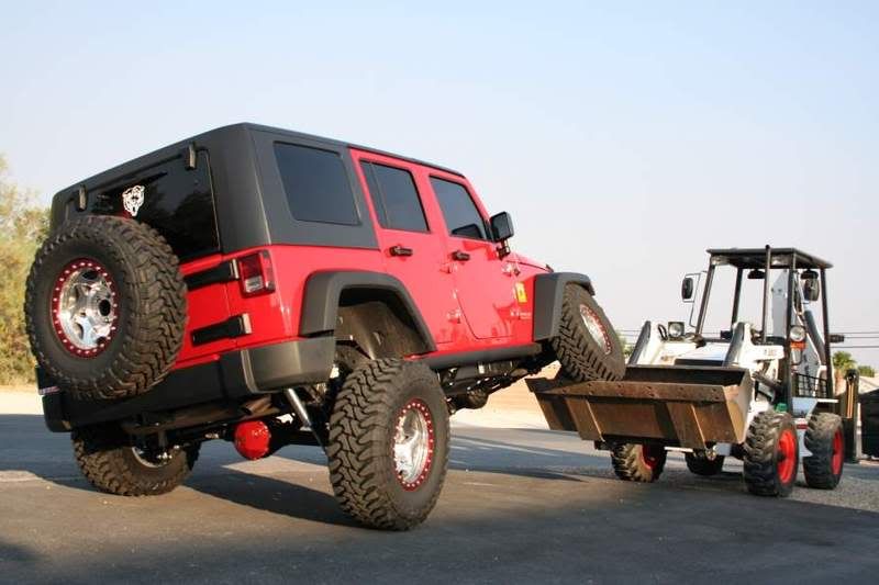

Of course we had to take it out in the dirt... LOL
vegasjeep is offline

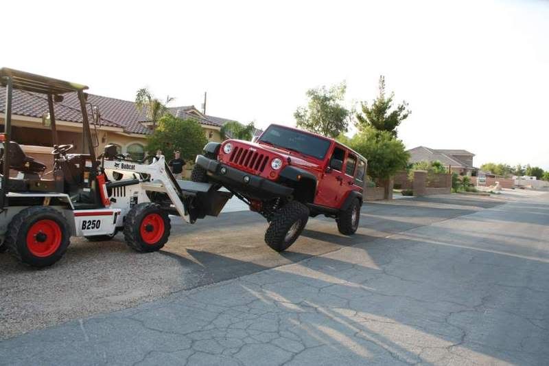

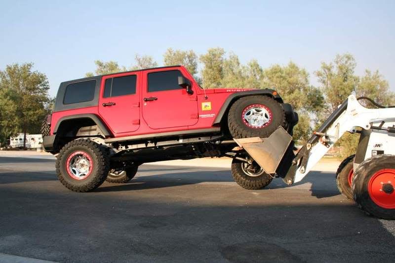

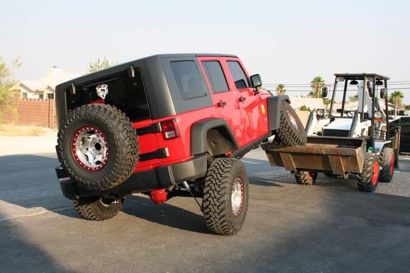

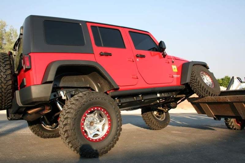

That night I decided to get out the Tractor and check out the Flex that the 4" Ultimate Kit gave us for our Rubicon Trip in 2 weeks. I was quite impressed with what we got. I think we would have more but the factory Rubicon Electronic disconnect was our limiting factor.

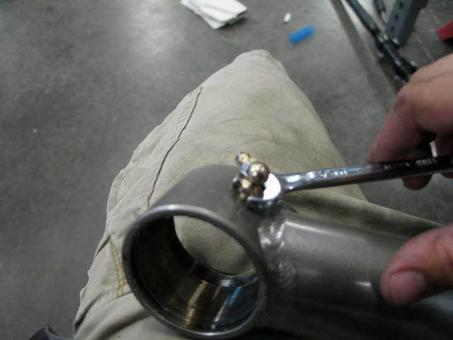

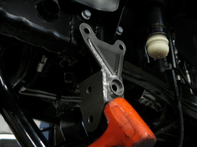

We pulled it back in last night and welded on the ORE products.
These pics were of Two different Jeep JK we welded some C2 braces and Control arm braces on.
I was thinking an hour job or so for each jeep. By the time you get the wheels off and everything disconnected and out of the way along with grinding all the spots that need to be grinded I would give about 3 hours per jeep. We were making sure they fit and looked even and right.
This is the lowers being welded up. They need to have a bead ran down them before installl.
We never ran a bead longer then an inch at a time. Often switching sides and going form top to bottom to be sure to cool everything off and not destroy seals or ball joints. We used two rags and had a bucket of ice cold water handy in which we doused the two rags in the ice cold water inbetween each weld and let the water drip while working on them. When the weld was done we would really makes sure ball joints and other vital areas were cooled off quickly.
