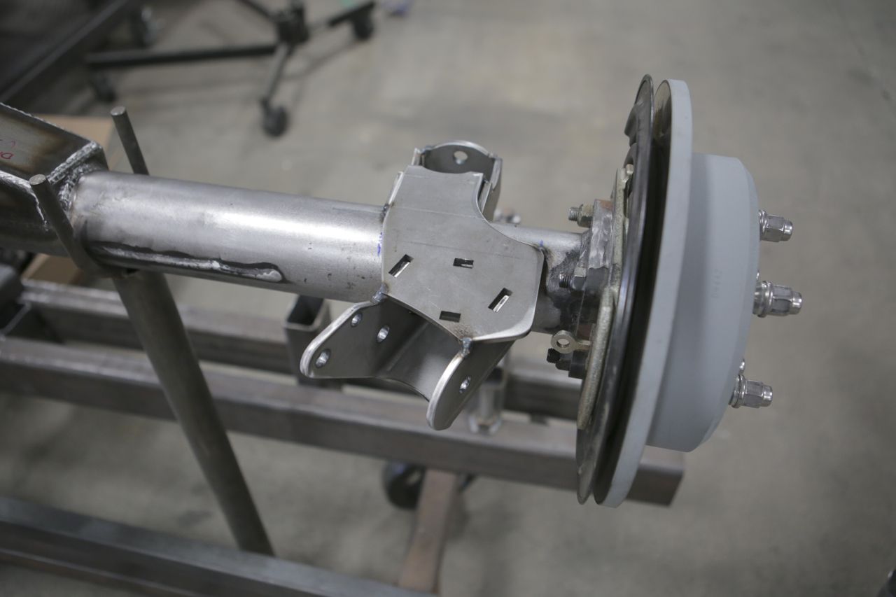

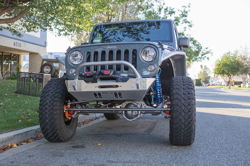

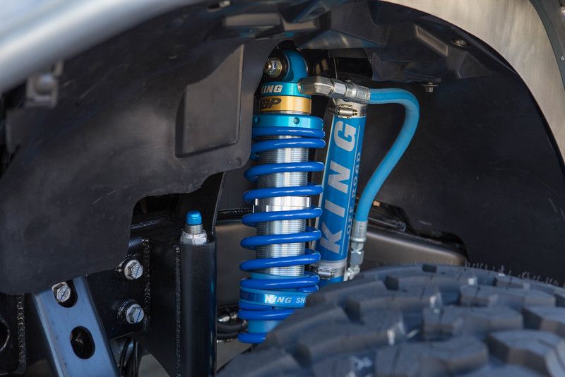

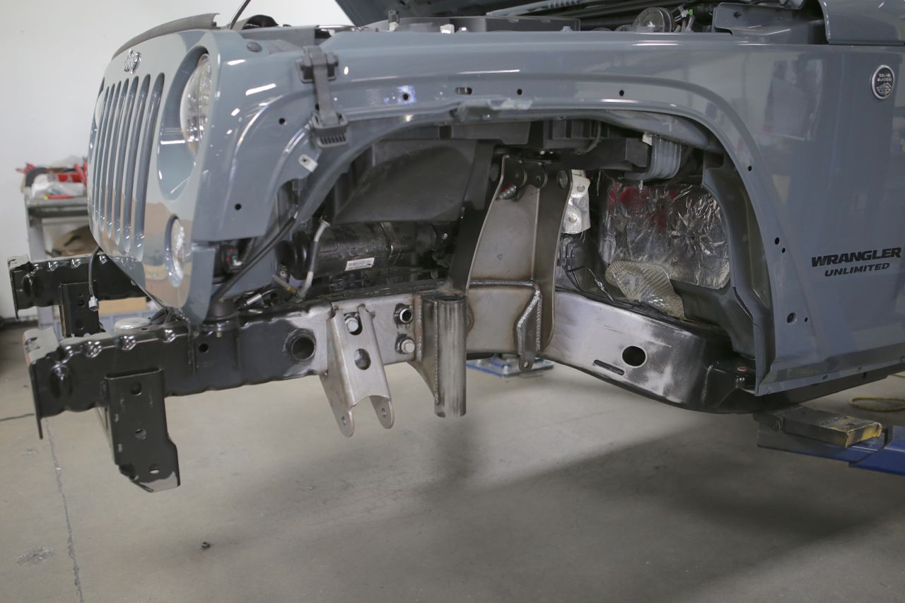

This customer brought their brand new Anvil JK to us for our Elite Coilover Suspension System and some GenRight Aluminum armor. This system is designed around Currie Rock Jocks 60s so we had to make some adjustments to install the system with factory Dana 44s. This is a complete system with all the suspension parts, new gas tanks, skids, etc.
For more info on the kit, check our website: http://www.genright.com/ProductInfo....4#.VH-N5jHF_E0

kewlbeansbro's Avatar

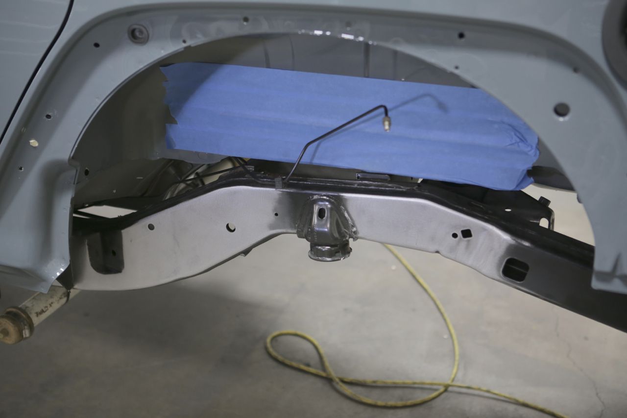

You guys sell these rear towers or that all custom for customer?
I think whoever owns that is going to be very happy!!! Nice work!

Those parts are only available as part of the kit. We had some very bad experiences in the past where folks tried to mix and match or piece together similar kits from GenRight. Then they bad mouthed GenRight when it didn't perform. Unfortunate...........

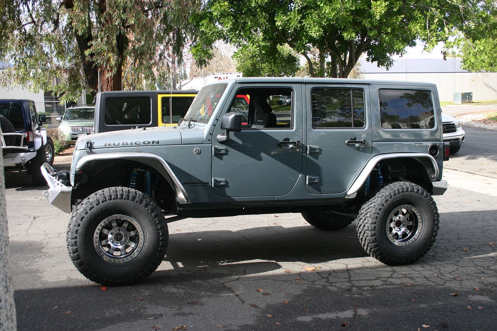

Here's two more. There's still a bunch of work to be done: Sliders will be installed today, ride height needs to be adjusted, etc.
Found out some more about the build as well.
300M RCVs front and rear, regeared, JE Reel 1350 driveshafts, upgraded King Shocks (externally adjustable and internal bypass), 10K WARN Zeon winch, Raceline Avengers wrapped in 37" Falken MTs, Reid Knuckles, PSC hydro assist and GenRight tierod and draglink setup! That's A LOT of nice parts!!

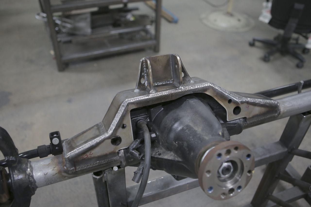

Are those reinforced axle tubes?

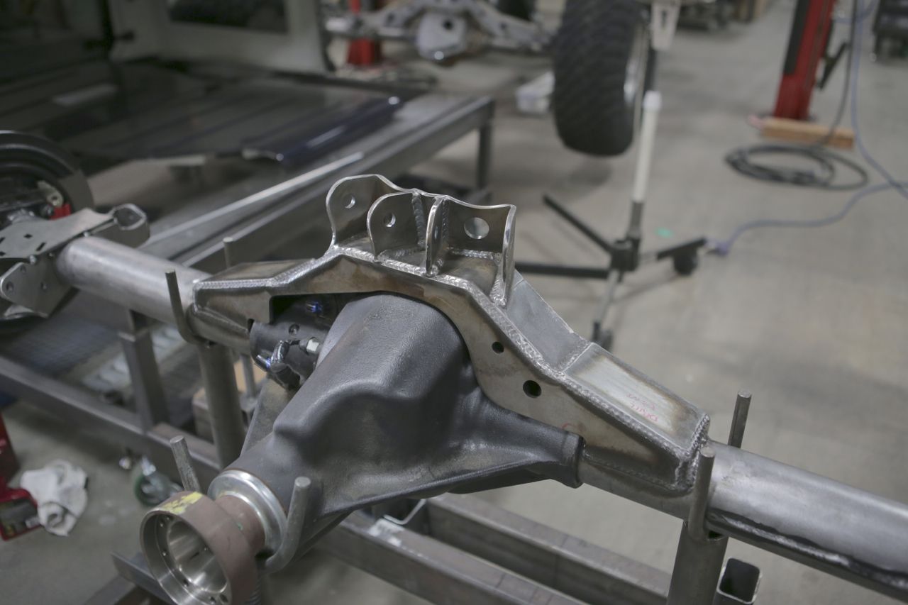

Really like the reinforced cross section integrated into the rear towers.
I get that it includes a set of King C/O's and bumps, but having a tough time wrapping my head around the 14K buy in.
New fuel cell, new aluminum skids, etc. It's a complete system.

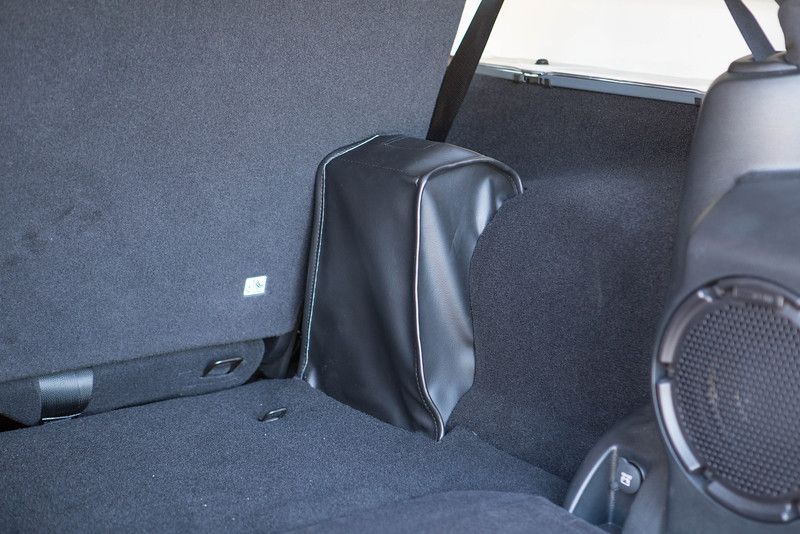

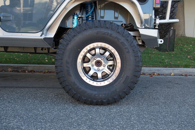

Wheels are Raceline Avengers. If you haven;t seen them, they're relatively new and they're Jk specific. Tires are 37" Falken Wildpeak MTs.
A local upholstery shop made us some nice covers for the shocks towers.
Still needs some winch line.
And the ride height still needs to be adjusted.
This customer opted to upgrade the Kings and add their air bumps. Nice!

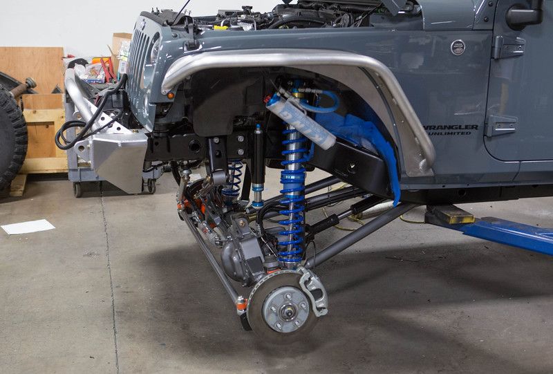

I'll say it again. Absolutely stellar.
What about that RAM location though? It looks like it's between the tie rod and the axle, rather than above the tie rod. Personally, that would get damaged on my jeep with that set up.

here is a pic of what someone else did to compensate for the new height adjustment for those knuckles.

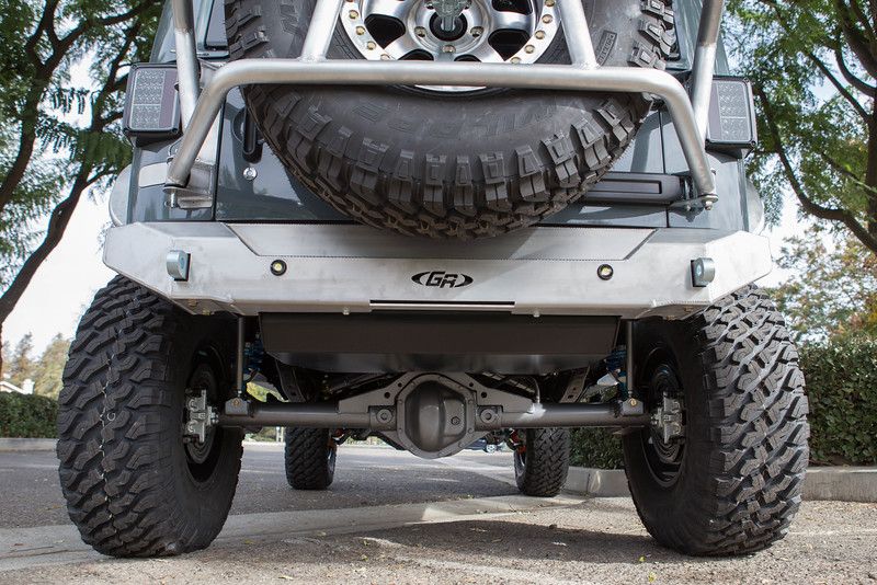

So it's done and ready to be delivered. This is a great build! We installed the sliders, set the ride height and tested clearances. We added some Master-Pull synthetic line with a Factor55 Prolink, an LEDWarehouse.com 50" single row light bar with our GenRight lights mounts.
And the pics!!
Are you guys running a Prolink on your winchline? If not, you should check them out. It's one of my favorite additions to my Jeep!

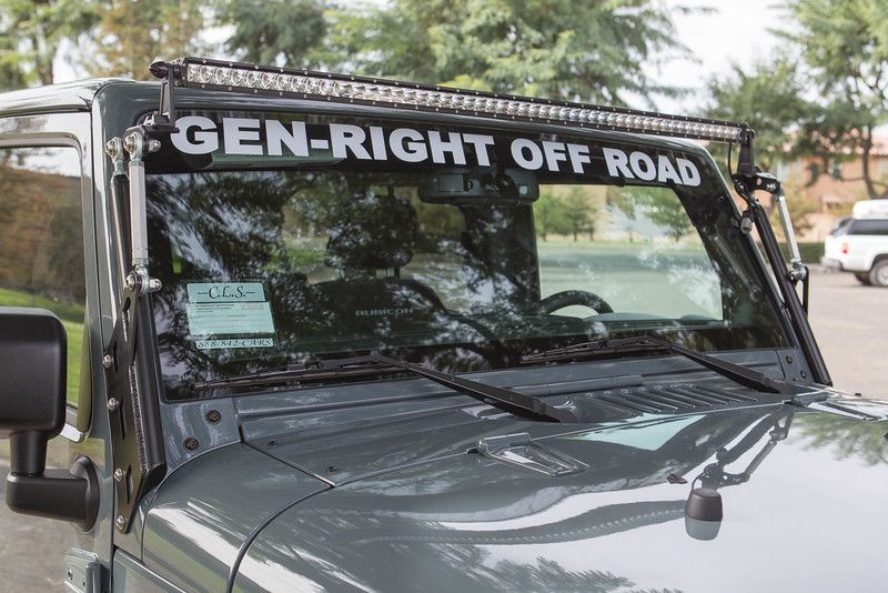

LEDWarehouse.com 50" single row bar with Carolina Metal Masters light locks and our light mounts:

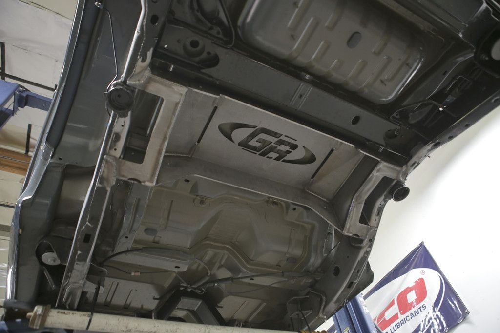

With this kit, the fuel tank gets relocated to the rear to allow for max articulation!

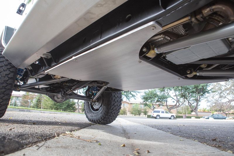

With this system you also get an aluminum skidpalte. Notice that everyhting is flat underneath. Even the control arm mounts are moved up, out of harm's way.
