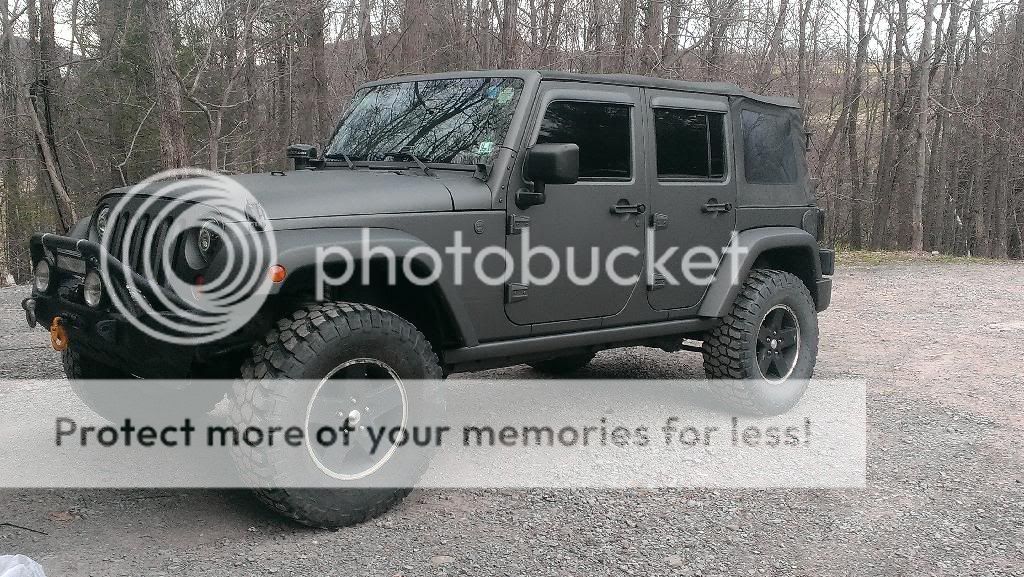

well after a coworker got a large amout of industrial paint overspray on my jeep and many failed attempts to remove it i just sanded it off, decided instead of buffing it i would try out the plastidip. did a basecoat of gunmetal and then 2 gal of anthacite, i did the flares and rockers but not sure how long it will stay on there

he painted the roof of his race car outside with a primer gun and overspray went over most fo the cars there. it came off everything but my jeep, we got some special sponge thing bodys shops use for overspray and it just took the clearcoat off on mine, worked fine on everything else, not sure if jeep clear is crappy or just not as good as gm clear as all teh other cars were gm

i used more than needed only because i ordered the wrong color and its not returable so 1.5 gallons of gunmetal as a base and 2 gal of the anthracite. theres a couple messed up spots that hopefully wont peel but if they do i can just peel the entire panel and do it again

i have about $300 into it, but i got it when there was a 20% off sale. i bought the sprayer and that was over $100 also differnt colors are different prices. a full size truck would prob need 4 gallons to cover good, the thing with this stuff is if its to thin its hard to remove.

i wanted the flat look. i may try some glossifier next time, thats whats cool about it is i just peel it off when i want a change, or just spray over it

if it was hard to peel (like it kept breaking in little peices) it wasnet on thick enough. we peeled my friends '12 F250 in about 45 min the morning before he traded it in. and if the dip is in a hard to reach place they sell a spray that will take it off
as far as durability goes a single drop of water left on a part before its sprayed will make the entire peice peel. has to be super clean and completly dry.

i did, and it did work but took me a hour just to do the end of the cowl (where you get a mirror dent) i didnt want to spend 200 hrs doing the entire jeep and after i tried that i tried a pad thats supposed to be made for removing overspray and it worked great on the boss's yukon but scratched the shit out of my clearcoat, im guessing the gm clear is better than jeeps. So after that it looked like i wet sanded the jeep.
