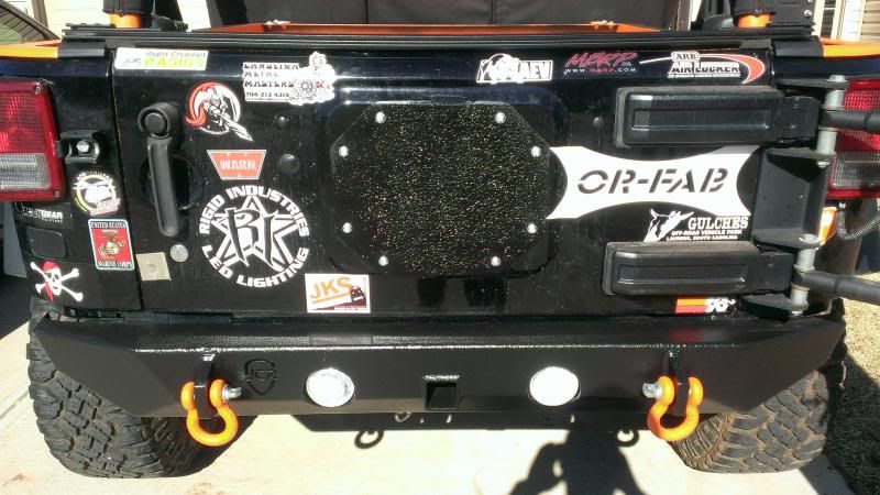

Made my own solid plate spaced off the gate just enough.
I'll post a pic tomorrow.

I did the same thing. Put the tire carrier on a piece of aluminum and marked the edges. Cut it out of the sheet, drilled the holes and cleaned up. Threw on some textured paint and sealed the top/sides. I used some foam sealing material from Lowes. Started at the edge by the bottom bolt and followed the edge up the side around the top and back down the other side to the other bottom bolt. The lower edge is not sealed so the air flows freely. Picked up some screws while at Lowes and popped it on. I believe the screw size was a metric M8x1"

Yeah as soon as y'all stated that it was like duhh, just seal the top and the sides, figured that I would space it off a bit for good measure. Thanks!
