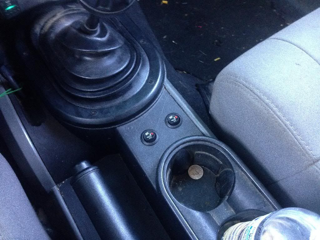

Hey Goodie,
Just thought of something else. Where did you put your switches?

Sorry picture, but there. It was easy for me to tie the two circuits together and run one lead to a fused switched 12v circuit from here. Didn't have to take apart much other than popping out the lower dash panel and shifter boot.

Thanks for the switch pics Goody. They look nice.

Goody- do those switches look sealed? The location is convenient, but stray coffee ooze worries me. I was thinking about somewhere on the center column or on my 12v guy panel.

They aren't sealed and that would be a concern for some. I don't frequent cups in my holders other than cans or bottles, so I am not too worried about it. I also don't really leave the Jeep out topless to get rained on. Its a concern for someone that does either of those, but for simplicity and not spending much time on the install..it was a good spot.
I'm good with electrical, but I hate actually doing it. Faster = better, I can easily replace the switches later if I have to.
