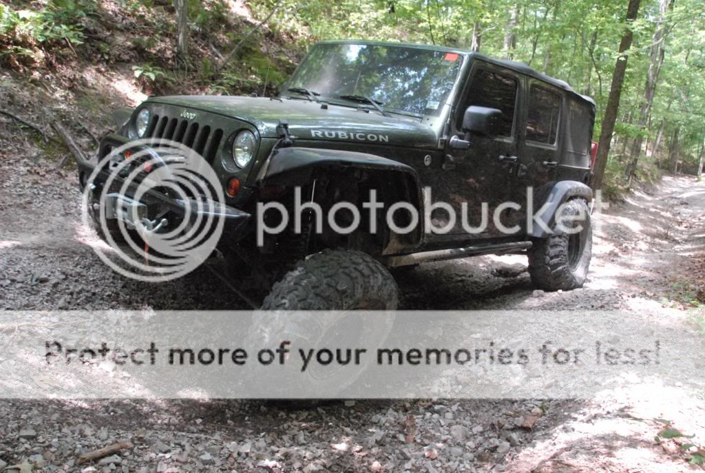

Those are what I was thinking of running. Got Any pictures?

Big A that looks great!

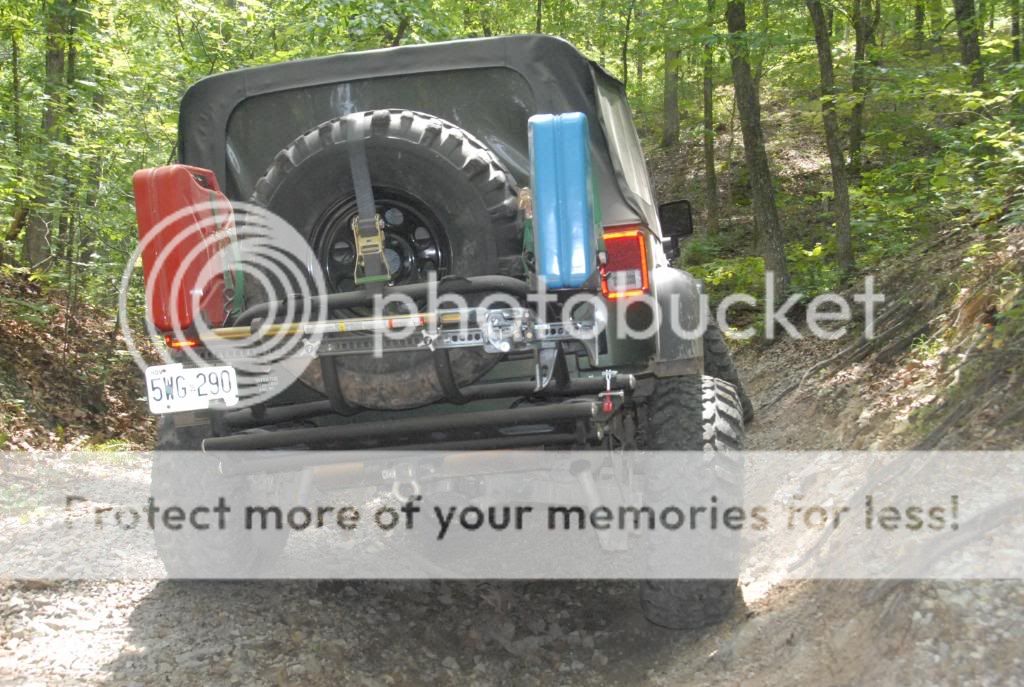

Here ya go.
