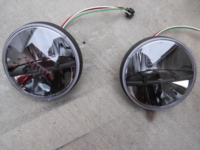

It's Saturday morning and time to for the install. Here are the Truck-Lite LED's fresh out of the box. They are significantly heavier than the plastic OEM headlights

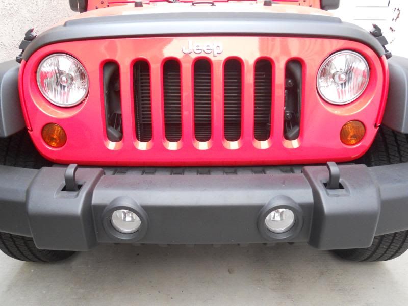

Here is a photo before the install
The 6 upper plastic retainers were removed and the lower grill was popped out to get to this point. You will need to forceful when pulling the lower 6 hold down clips out of the retainers, just be careful and use a quick snapping motion

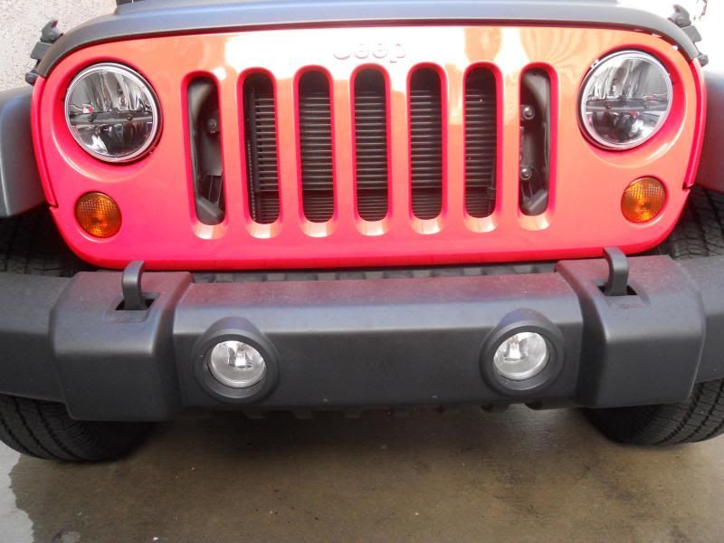

Now just reverse all of the steps and here is what they look like
Here is another shot
And with them turned on. Can't wait to hit the road tonight after it gets dark to see the difference in visibility. I will post the install of the Isee-Systems military LED JK tail lights once they arrive in 2-3 weeks (built to order)
