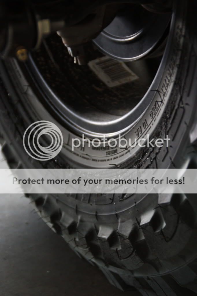

Just did a run today, and thats the inside of my left front tire. I have no idea what did it, but it is in the same place all the way around the tire so it's rubbing somewhere, what should i do?

Its from the bolt on the sway bar disco....either flip the disco to the inside and rebolt it or get wheel spacers....IF you paid someone to put the lift on i would take it back and make them fix it and buy a new tire....
