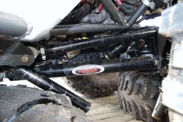

If anyone has facts or can chime in to what may of happened please share your knowledge.
Thoughts and prayers go out to this guy and anyone involved in this accident.
Here are a few pic's of the rig on a trailor.

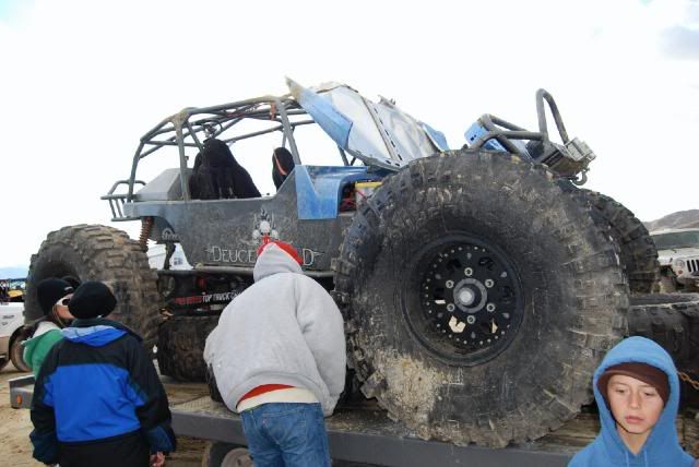

For anyone who might be going out for the KOH you can see this vehicle near the trail-master tent then go back towards the main tent, I was wowed when I saw the damage,
Rockwells and a massive set up there, I think it had a blown V-8 too, 54" tires.
Look @ the drivers rear tire where it was bent also, this guy is lucky to be alive if so, prayers go out to them.

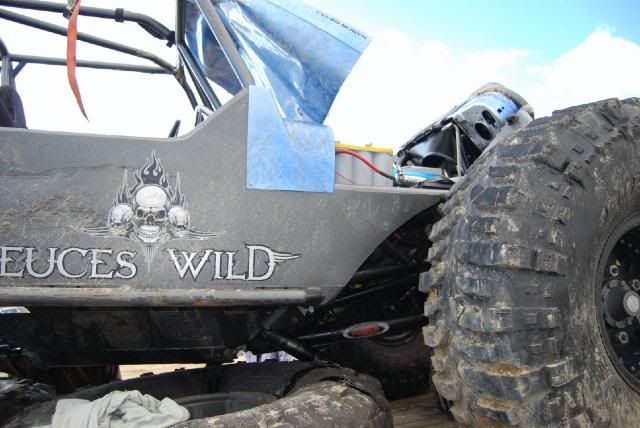

Both driver and pass, were in the trailer the next day and doing fine. the pass said he was sore.
The front engine cage was not designed very well if you ask me or anyone else that really looked at it.
There was no top tie in to structure and that front end got pushed up due to the bump stops hitting the axle pads and just ripped one i believe 1.75" tube and bending another, per side.
He did say they already called and was off to another chassis builder once they get back home. Must be nice...
