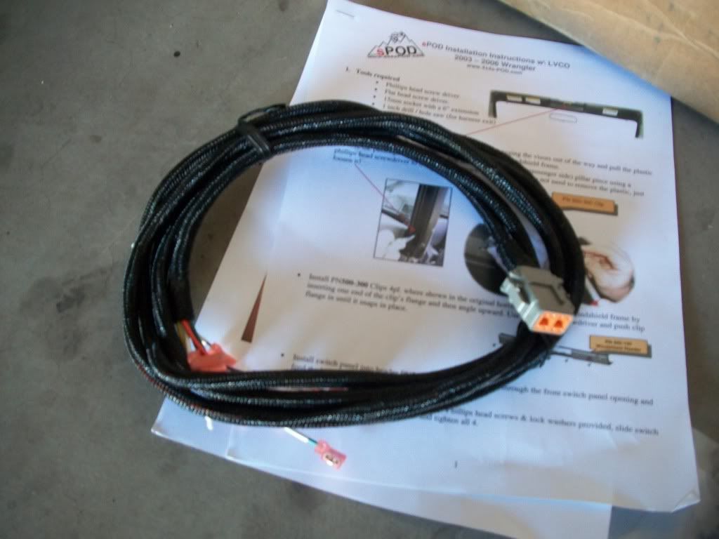

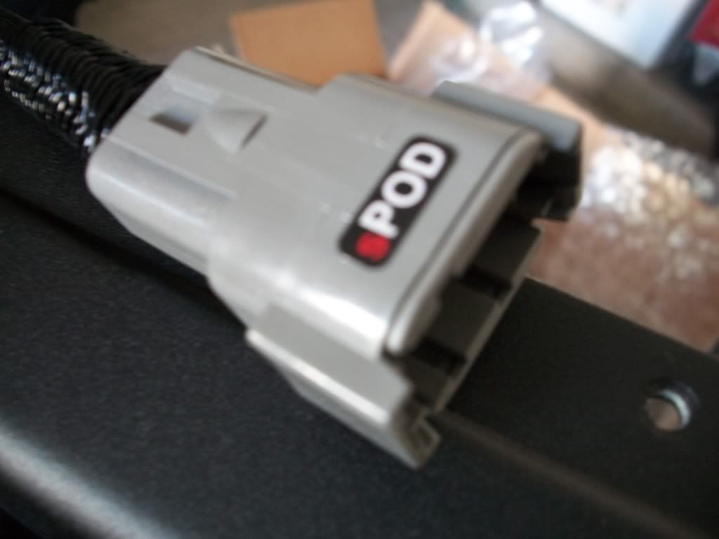

Ok, I am not the best at reading instructions so I had to start with my coffee.
So now I am ready! I started by reading over the very well written instructions and they were in color very nice. I opened the box to find everything very well packed and separated. I like the fact that even one parts bag had everything seperated to it didn't get all mixed together.

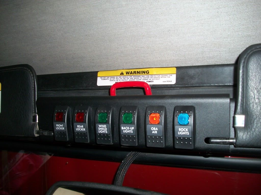

There are a few options when ordering the spod. I opted for the low voltage cutoff which saves your battery in the event that something gets left on. Also I got the stickers to I could label the switches very important if your wife drives your Jeep and your 6yr old lights the pretty colors on the switches.
I was also very impressed with the quality of the switches,wiring and fit and finish...nothing is done half ***.
CONT

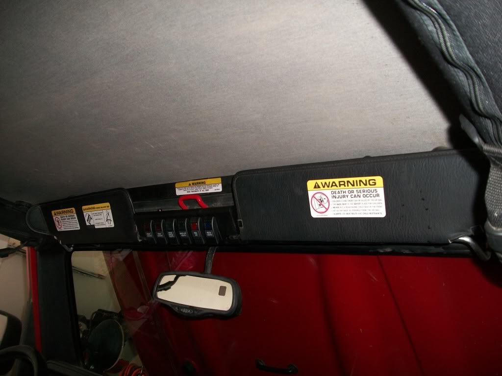

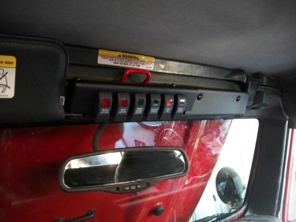

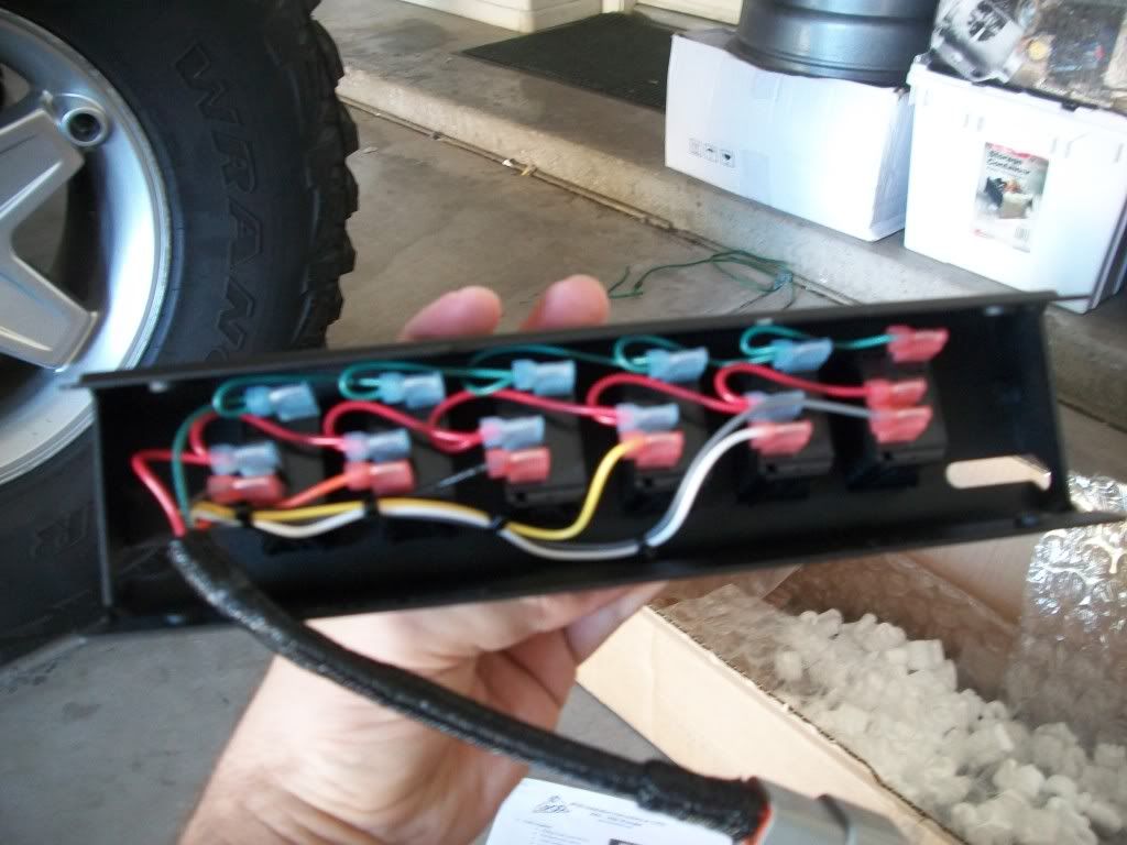

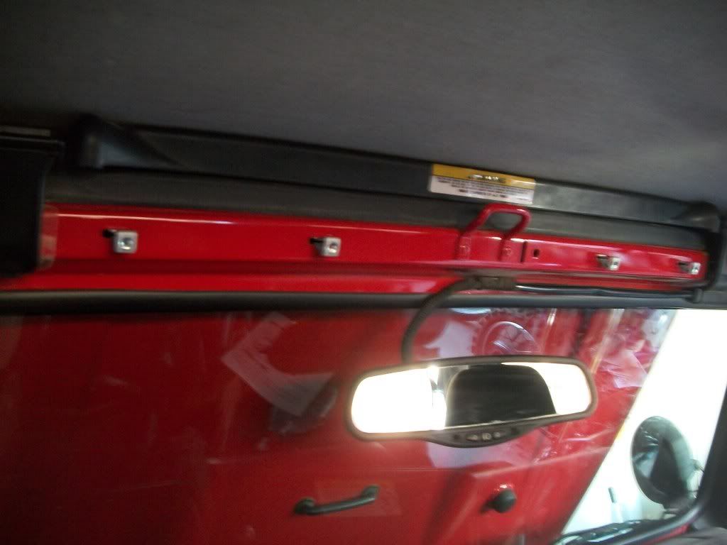

Ok now on the the install. First I removed the front plastic header and removed the passenger visor/loosened the 3 right A pillar trim screws. Next I inserted the 4 clips that hold the switch panel in place. Next you assemble the switches to the metal frame that replaces the plastic header trim piece. Before you bolt it all together attach the wiring harness and route it through the passenger a pillar and the dash. So far very easy and anyone with hand tools can install one of these. Also note the slots for the visors, very nice attention to detail.

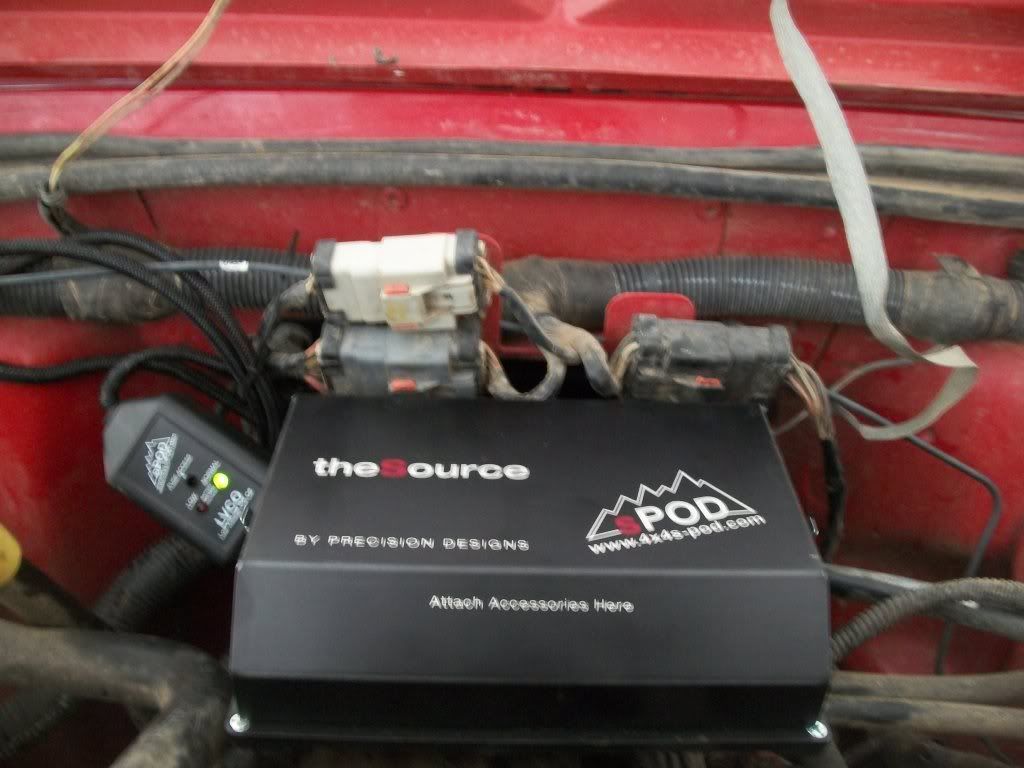

Ok now we drill a hole in the firewall just above where the passenger put their feet 1" hole-saw. Install the grommet so the wires do not get cut and feed them through the firewall. Now the dirty part..it has to be dirty right? This all depends on how well you keep your engine clean...well lets say I should have cleaned it before hand!
Using a Phillips screwdriver disconnect the "Source" from the mounting plate.
We now install the mount for the source very simple using a 15mm socket and some muscle take off the bolts which are ground bolts. This is important to reconnect them last as your Jeep may not function right if you skip this step!
Reconnect the source and route the wires through the holes on the back side. This part had me worried as I am not keen on wiring! No big deal every thing is numbered so its easy to connect and if you have the LVCO connect the positive wire to that.
In the photo you will see I did not do that but later corrected it. You will need to also need to connect the pos and neg to the battery.
Now you are ready for the easy part, installing your accessories! The Spod comes with new connectors and shrink tube to make your install look professional. Once connected you simply loosen insert plug and tighten with a Phillips screwdriver pos & neg. No need for relays since they are pre-mounted on the source. I decided to just hook up the front locker and I am replacing the front lights. My rock-lights were cheap Walmart's so they failed after one year so I will need those too. Oh yeah and pretty much everything else you see missing off the switches I labeled!
