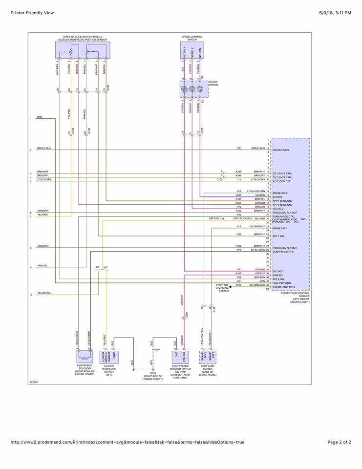

2011 JKU Cruise not Working JSS 5.7 Truck engine
Last year around August I bought the hemi Truck swap kit from Jeep Speed Shop. After some shipping shenanigans I finally received the kit in a much abused and battered box with holes in it. Parts were missing. JSS told me cruise control worked with his kit, and I have been waiting since last September for a switch.
Anyone have a 2011 Hemi swapped JKU with working cruise control?(I know AEV works. AEV wont sell to you if you didnt buy the AEV kit)

My guess would be the voltage differences between the 07-10 switch and the 2011+ switch.
JSS probably has the PCM setup as a 2010 so it will be looking for the voltages from a 07-10 switch.
The TIPM doesn't really have anything to do with it other than telling the system that it either has the cruise option or not.
The Cruise switch is wired directly to the Jeep PCM.
Could you get a PCM for a 2011 or 2012 Hemi? I bet the cruise would work then. Or splice in a early 07-10 cruise switch at the base of the column to test

The 2011 JK has the new interior so the cruise control switch is in the steering wheel. The 2007-2010 JK has the cruise control switch on the column. The 2012+ JK has a different ECU due to changing to the 3.6 & NAG (somehow that is relevant to cruise control).
The 2011 is pretty much a stand alone year. Several of the electronic parts will only work in a 2011. My understanding is the cruise control switch in the steering wheel has to be “rewired” inside the switch itself for the cruise control to work. I believe AEV includes this in their kit for the 2011 (which is why the 2011 kit is more expensive). Todd at Jeep Speed Shop will sell you the switch.
I have a 2011 JK using a JSS 5.7 kit. I don’t have cruise control right now either, but that’s only because I haven’t bought the new switch yet. I have too much fun with the gas pedal anyway.
You can't rewire a 2011 switch that I know of. You can rewire a 07-10
I would bet that AEV sells a "box" that has some circuits and resistors in it to make it output like a 07-10 switch

What pins did you have to change? Have a photo, or a diagram?

Is there anyway to use a 2011 JK ECU and have it programed for the HEMI? That would allow the cruise to function with the 2011 stock switches.
Maybe try a 2011 Grand Cherokee ECU. they run the same cruise switches.

The PCM I have came from Jeep Speed Shop. At the time I bought the kit, Todd told me the Cruise worked with his kit. It has never worked with mine. I tried to reach out to Dan at Dakota Customs as he states he has a PCM that works. Communication fellow apart when it came time to paying for it, I never got an invoice. For whatever the reason, I can imagine a couple. The various kit builders out there don't seem to like to cross sell parts. IE it is either buy it from 1 merchant and your stuck with that guy, or nothing. Multiple conversations to JSS have resulted in the same response, the guy that makes his custom module is not available. In the meantime JSS is leaving his customers in the lurch. While I know it is only a convenience item. Wether I am on a 3hr drive to the beach, a 45min ride to work, cruise is nice to be able to just sit back and soak it all in even if it is just a minor convenience.
