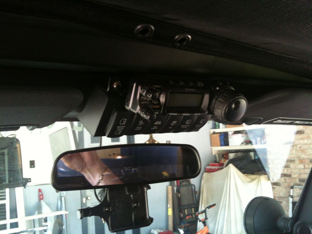

As mentioned 10 & 12 meters aren't going to be of a lot of use to you so if you buy the radio what you're really buying is a tuned CB. That said generally speaking the electronics in a HAM radio are usually of much better quality than what is in most CBs so I would still say it is a good buy for the money. If you are truely interested in HAM radio though most people use 2 meters on trail rides. 2 meters also gives you acess to a huge repeater network in most metro areas. If you're interested in real long distance you probably want to look at an HF radio with 20 and 40 meters being the most popular. One thing to think about with HAM radios in a JK is RF interference; the electronics in JKs don't much like higher power radios and can lead to a lot of work bonding (grounding) to get rid of it.
All that said its worth the trouble (to me anyway). Picture of my rig

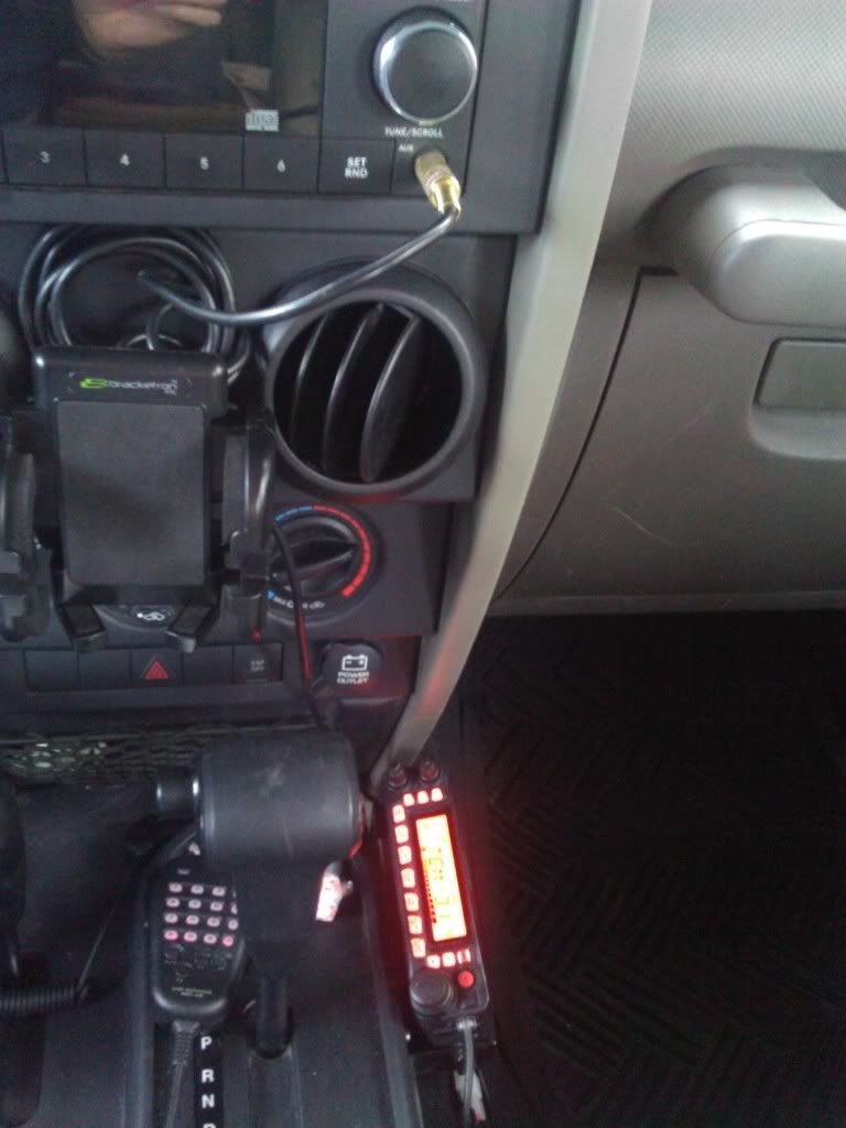

I would highly recommend the Yaesu FT7900R. It is dual band 2m and 440. It is compact and comes with a remote kit to mount the body away and just have the faceplate if you want. It is crystal clear and holds up well to use in and out of the Jeep. Don't buy a rig that has been modified to run in the CB band. It is illegal and unnecessary for your needs. I have a little CB unit that works well for trail use and I use my Ham for regular commo on the road and everywhere. By hitting repeaters it goes a long ways and picks up folks that can and will have great conversations with you. You can use it to assist with all types of races (bikes, runners) and emergency use.
Not a great pic of the unit but it shows that I run the aux jack in the back and have my Ham radio on my Jeep speakers so I can hear on the trail or running down the hwy doors off. I do this with my CB also on the trail so I can hear it when I'm out of the Jeep standing around waiting. I've lived an interesting life but my ears haven't enjoyed it all. (heavy equipment, Harleys, lots of guns, helicopters...) Yup, I'm old
