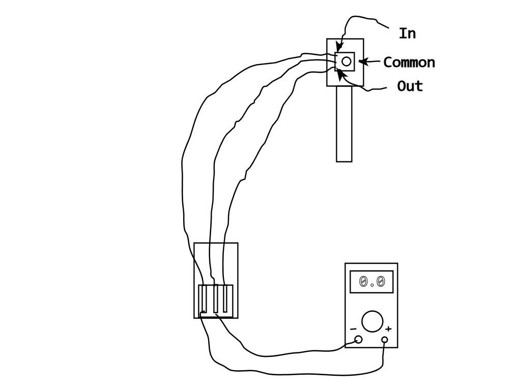

Your remote has a loose connection or a bad switch more than likely. See, those are little details that change the response you get. The remote should have three pins. If you have a digital multimeter, you can check the pins on the control to rule it out by finding the common pin and the checking both sides of the switch. Refer to my rudimentary drawing I just whipped up. One of the pins is the center of the toggle switch. One of the pins sends +12vdc to the IN solenoid and one of the pins sends +12vdc to the out solenoid. If only one side tones out, either exchange the controller or replace the toggle switch.
thanks I will have to check that tomorrow!!!!
by the way i like your drawing thanks it really does help!!!!
