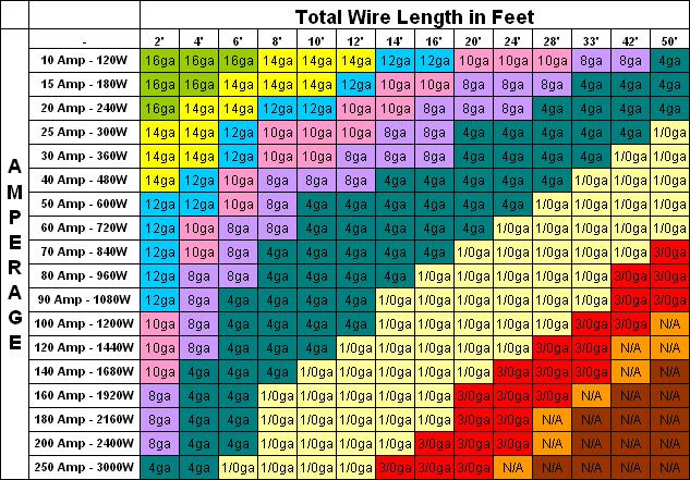

I don't know the power of the amp... but here is a simple chart for power cable. For grounds, I try to keep the same or larger guage wire.
If your dropping voltage after the proper power AND GROUND. Next up would be the battery then Alternator. Make sure it's got enough amperage to carry to load of the car AND radio. Hope this help.
