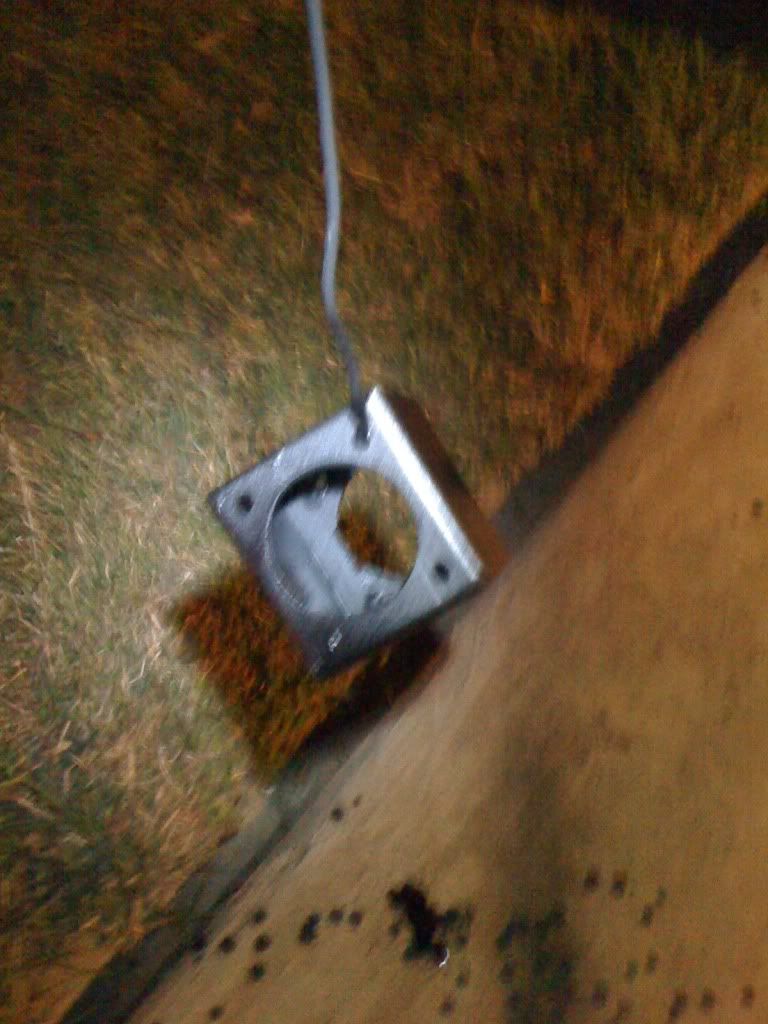

I installed mine directly in the ass end under the tailgate.

You mean into the body sheetmetal? Got a photo?

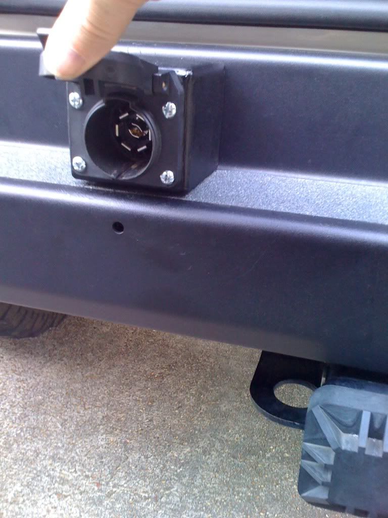

I built a little box for mine and bolted it to the bumper

Nice box! Is that steel?
mounted it dead middle

Doc, does that protrude into the storage puka under the rear floor, or into a dead space?
storage space where the jack is. seeing as the factory jack is kinda useless with 37's it could go

Thanks. How did you seal that off?
silicone.

Yes; 1/8" steel
