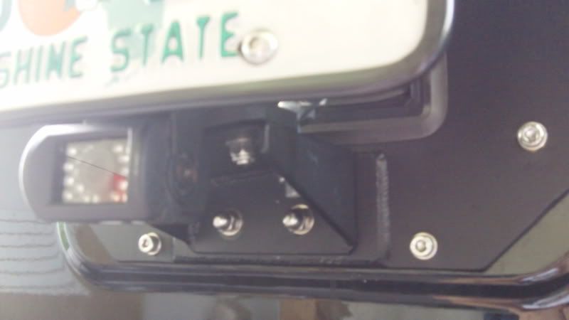

I got one like this off EBAY http://cgi.ebay.com/BACKUP-CAR-REAR-...item2c57e10758. Was cheap and works great.

Off the pavement it works decent, with the help of my reverse lights. Sometimes I don't use it though at night on highways, cause when someone gets on your ass it can be blinding.
