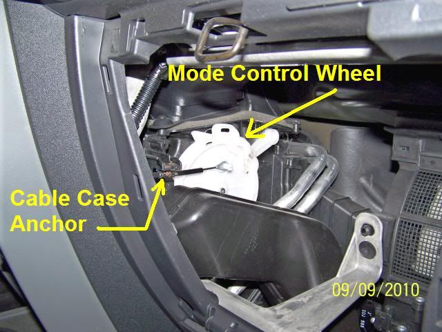

Sounds like the cable has become disconnected from the knob, or from the mode wheel.
Remove the glove box. Look in toward the center. The white plastic wheel is the mode control.
See if the cable is connected.
If it is, turn the mode control knob. If the white plastic wheel does not rotate, the cable has disconnected from the control knob.
Another possibility is the cable casing anchor has broken, making it so the casing moves back and forth, instead of the cable.
There is a cable casing anchor on the end by the control knob, too.

Great suggestion. Installed stereo a couple months ago, and pulling out the center console resulted in separating the mode control wheel from the cable mechanism. Remember to reseat at full left or right to maintain the proper range from foot to defrost.
