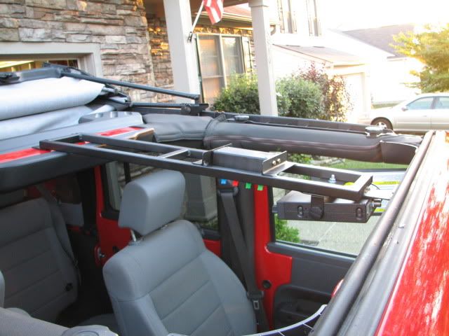

thought I'd share some pics of my overhead console. i was looking for a place for my cb, switches and some room for more things to come!

they say you don't own the jeep until you drill a hole in it, so I did two just to eliminate any second guessing. those are 1/4-20 stainless bolts into the two holes that i drilled and tapped.
up front it's just a clamp basically. those are 1/4-20 grade 8 bolts welded to the top plate, makes it a little easier to get together.
and a shot looking down
I bet if you changed the back bit slightly to something similar to the front (where the box doesn't directly connect to the holes, but rather a thin piece of steel goes from the holes/bolts to the box) that you could get that to sit a bit lower and fit with a hardtop.
you are probably correct, however, i wanted it up as high as possible. i am 6'-4" and didn't want to hit my head on it as i have done in other jeeps with overhead consoles. i also wanted it high so that it wasn't as visible from outside the jeep.
