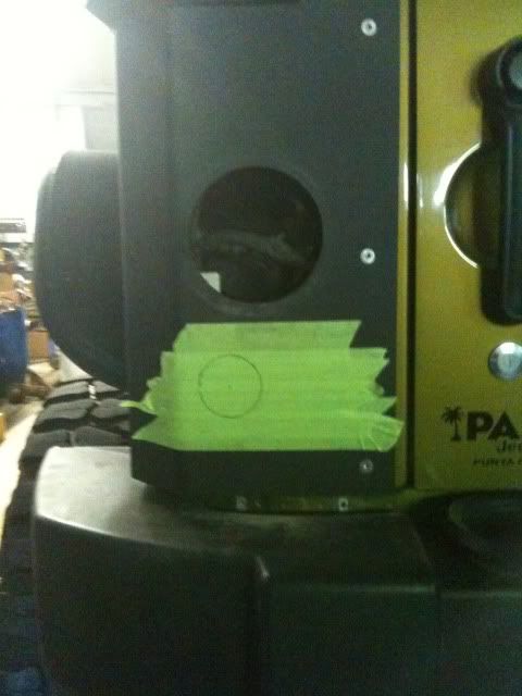

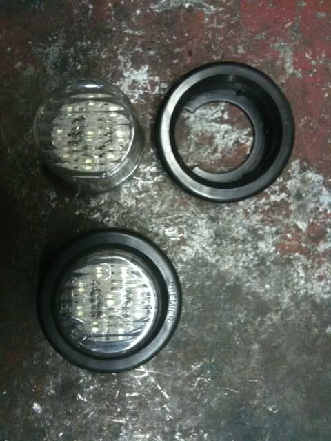

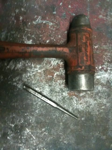

So ever since installing my Off Road Evolution armor I've been meaning to install some reverse lights. Well I scored some 2" LED lights on ebay last week and today got around to installing them.

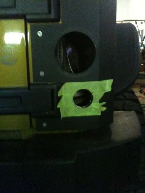

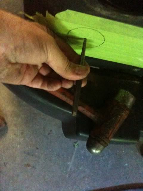

Figured out placement, taped off area to be cut, measured and marked holes...
time to use a big ol hammer and a center punch to get the bit started...
time for a lunch break and well well well, looky looky who stops by the shop
I'm pretty sure heaven looks similar to this... (the ceiling was crazy!!!)

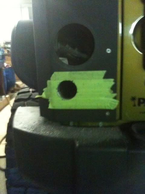

break time over... BACK TO WORK!

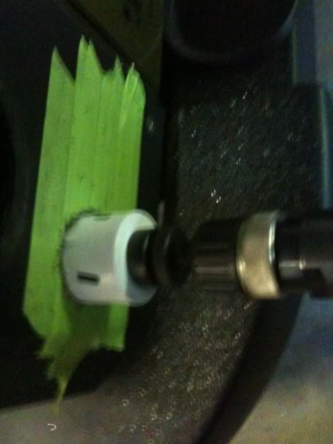

2 and 1/4" holesaw needed to make the cut (fun to cut through armor and then body, but air sure came in handy with the higher rpms)...

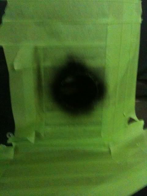

taped off surrounding areas and shot the bare steel with some black primer...

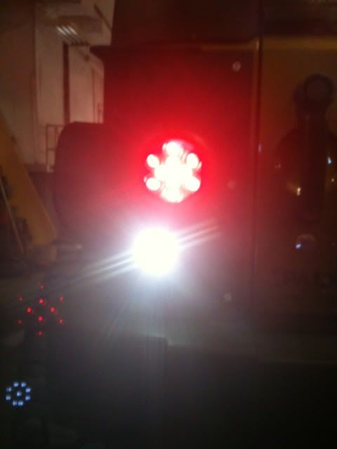

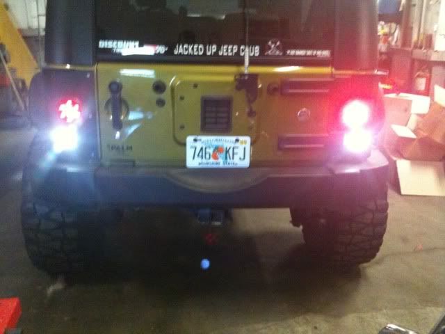

tapped into factory wires and WAHHLAAAH!!!

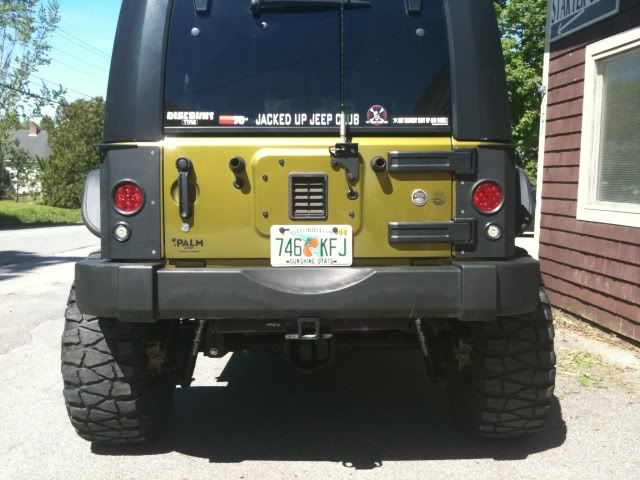

Due to the passengerside having the door hinges on it I decided to go with a non centered look. Glad I did because I really like the outcome. Goes alongwith the Jeep styling I think as compared to the front headlights and turn signals.
