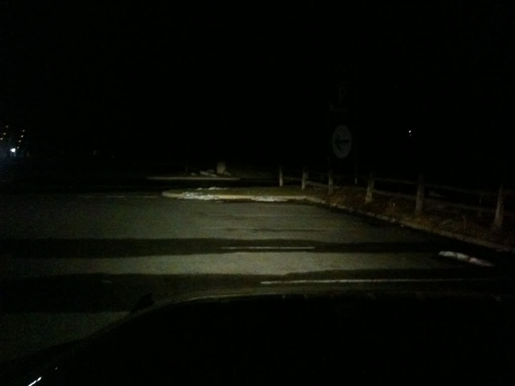

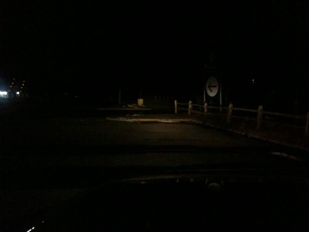

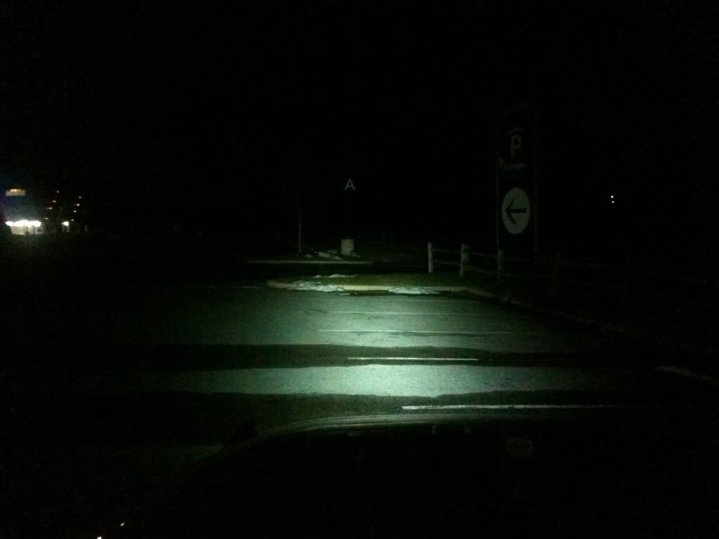

Ok I lied here are the pics of what I did, and som shots of the light.
low beams and fogs
low beams fogs 4 LEDs
highs
highs and LEDs
just LEDs
I need to mess around with aiming them some, and I might adjust the mounting a bit. All of the photos were taken with my iPhone, so not the best quality but you should get the idea

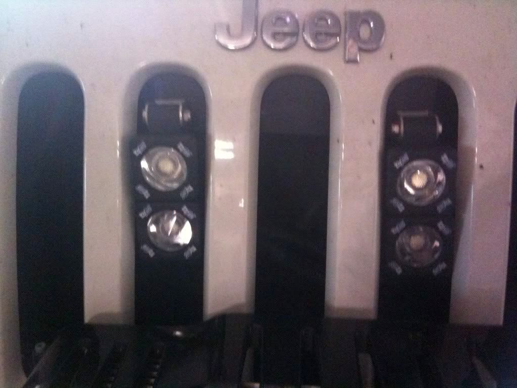

Ok, snapped some pics with the lights off to give a better idea of how they are mounted.
As you can see the lights fit pretty good between the slots of the grill. Originally i was only going to put one light per slot, but there was not enough room to make the mounting bracket work real easily, so I decided to stack 2 lights vertically.
You can see the plate that I bent up in this picture where the lights are mounted, I just bent a piece of 16 gauge steel with 2-1/2" legs on each side, notched out the one leg in the area where the hood latch is and used 2 bolts into the radiator cross member that I taped holes into. I have had it like this for about a month now, and while the mount may not seem that stout to read about, these lights are not heavy so it has held up well, even with all the wind pressure the front end sees.

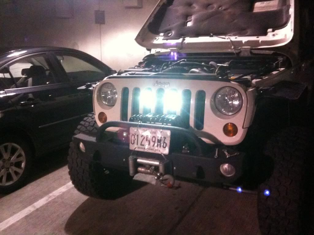

Some shots of everything lite up
Again Everything was taken with my iPhone, I left my camera at work, and since there is not flash on the phone I could not take pics of the mount real well.

Thanks for the pics... I think I'll be doing the same.

Those are great pictures. Do you use those for DRL's too?
