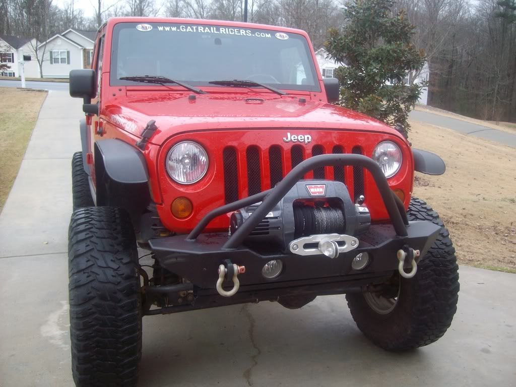

Hey Mike. Find or make an attachment bracket that uses one or more bolts holding the carrier to the tailgate. Just a simple "L" bracket with a hole for the antenna is all you need. It grounds good like that. You can route the wire inside the tailgate by making a bigger whole in the grommet. Then just follow the rest of the wiring to where you want the CB.
Get everything hooked up and I'll tune if for you and show you how on our next ride.
Oh and you will only need a maximum 4 ft antenna like this. 3 ft might be enough. You really only need about 6" to 1 foot over the roof since these antenna are top loaded. Any more just gets hung up on too much stuff.
You might also shoot a pm to Doug (Slippery). He's running a 4 foot stainless antenna on his swing away carrier. Ask him how he likes that. It's a lot lighter and more flexible than the fire stick. Them things are heavy and stiff.
I've been through about 4 of the flexible k40's. I won't buy another one. They break at the base.

And keep in mind that you might be taking advice from the only guy on here with his antenna mounted on the wrong end.

wrong end??? that's where i'm installing the antenna currently in the fedex box on its way to me.
I like front bumper, driver side. easy to see it and keep from taking it out on something on a trail. and typically less overhanging trees/limbs on drivers side. also putting a quick disconnect on it to remove when not on trails as that is the only time I'm going to use it.
So I guess you're calling him a dick for pointing out something dangerous, which kinda makes you a dick for calling him out and well holy fuck, it makes me a dick for calling you a dick.

Actually I thought that I would move it back when I got my new bumper, but i never did. The antenna hardly gets hit there and especially not on the base. It also acts like a limb riser at times. I'm prolly still gonna go with a 4 foot stainless though, but it's staying on the front.
Mine's on a disconnect and it comes off at home too. Only way to go. I don't need to listen to Trucker Steve either.
