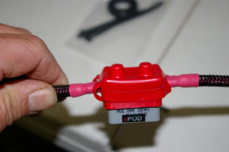

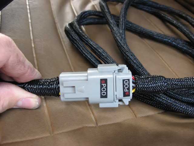

One of the interesting features of Jeep modifications is the high-level of execution of electrical modifications. While everyone should strive for a top-notch design and installation, it's scarily common to see hacked-up electrical jobs (search the forums), mostly on trailered rigs but sometimes on daily drivers as well. For folks that depend on their rig's reliability in remote locations, that is not an option!
All of our harnesses are individually wrapped by a specialized piece of equipment that is normally used in the race and aircraft industry with abrasion / heat resistant nylon: see below"
Our circuit breaker includes a boot to protect against shorting (CirKit Boss does not include this)
All your accessories power components will be attached in one place.

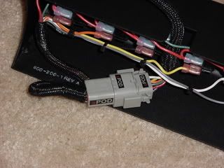

Behind our switch console:

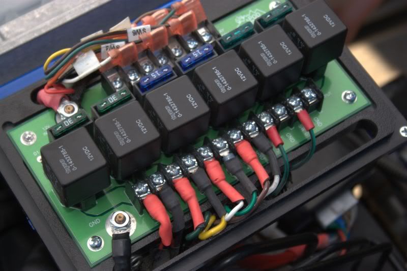

Basically no. It is more of an "old school" power distribution block providing fused circuits. There is one relay to power the ignition switched circuits. Power is supplied to the fuse block through a 40 amp circuit breaker. Then there are a total of seven fused circuits. Four are switched with the ignition and three are always hot.
The sPod system provides individual switches for each of the circuits provided. Each of the circuits is on a relay and is protected.
These two items should really not be compared. They provide very different functionality.
I installed the Painless one to get a fused power source for my heated seats, CB, and other types of circuits. I am using separate discreet relays for off road lights and such.

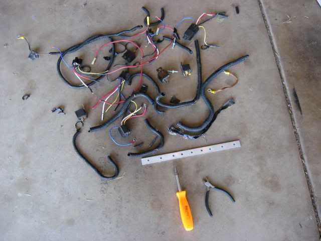

The 6-Pack Relay Bank is $290.79 and has 24 leads comming off of it. Imagine how many wires would be running under your hood!
some of the pre-wiring stuff that was replaced by one of our systems.
I think if you do the math, and being super realistic about the whole project, you will find that our system is very reasonably priced.
