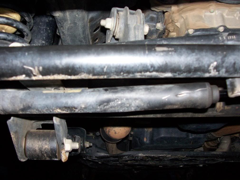

Made this out of 6" dia 3/8" steel pipe. Welded to bottom of bracket...shouldn't get hung up on obstacles anymore...

Not a bad idea really. Although I would like to be able relocate all that stuff myself.

I tried to relocate previously, using RE lift and droped tb brackets w/ Poly reloc bracket and Fox 2.0 stab....Spent much time and $$ and wound up w/ several issues that I couldnt resolve w/o spending even MORE $$...This temp fix was cheap, easy, and fast.

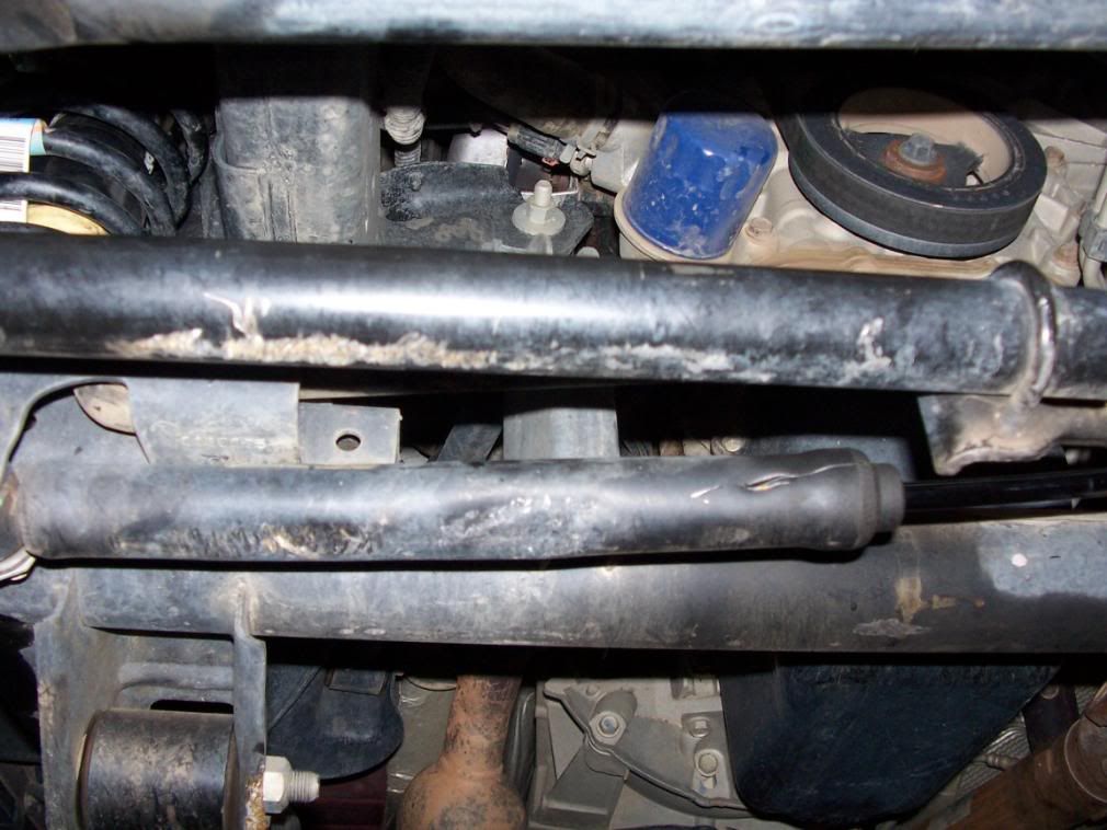

I just installed a Teraflex steering stabilizer along with the Woods relocation bracket at the axle end. I rotated the entire tie rod bracket up so that the stabilzer stud is pointing up and the factory tie-rod bracket is out of the way(the one you have so nicely skidded). It works great as far as I can tell. I just installed couple days ago and haven't had it off-road yet. Go ahead, ask for a picture! I'll get one as soon as possible.

No I hadn't. Here is one picture I have taken. I have a better showing the tie rod end, just haven't uploaded it yet.
This picture shows the Riddler more than anything, but you can see the end of the SS also.

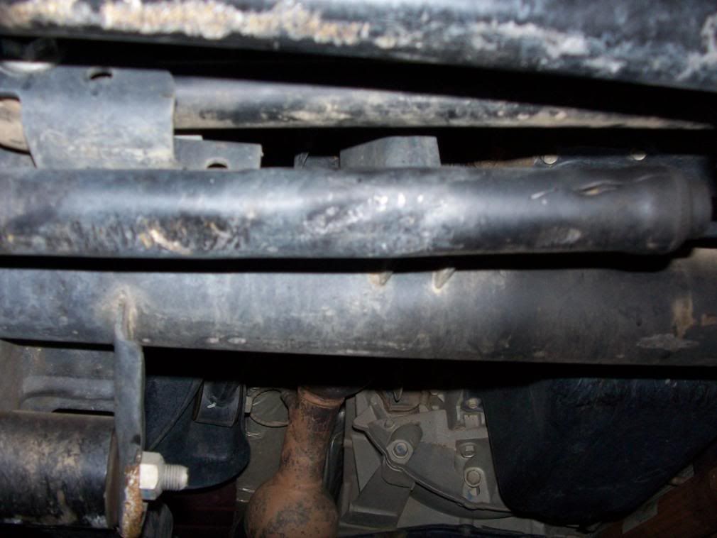

This is what happened without the relocated steering stabilizer....John Bull last weekend.........we'll be getting one from you soon, Woods
And this is what happened:
