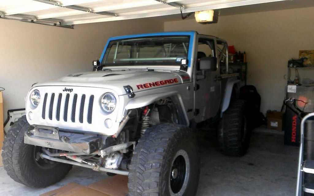

Day before it goes under the knife.

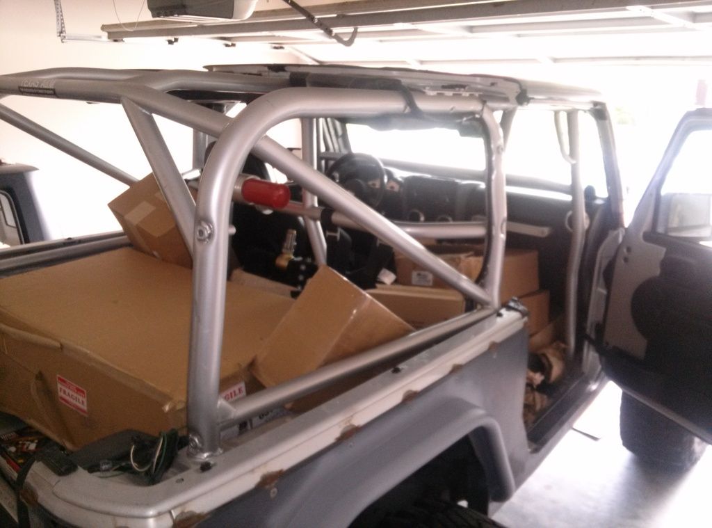

Crammed as much in there as I could, lot's of work ahead.
