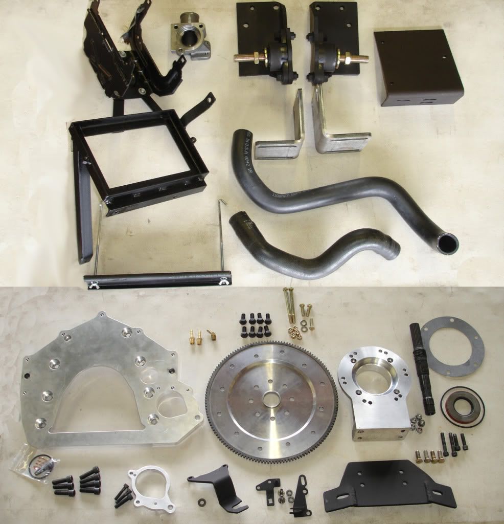

Fellow JKOwners we are pleased to inform you that after a many months of designing, engineering and testing we are ready to release our Cummins 4BT Diesel conversion kit for JK Wranglers. This exciting conversion kit is something that many of us have been dreaming about for quite some time. We are teaming up with Kenny from River Raider Off Road to release this kit and perform these conversions at our two facilities. Feel free to contact either Kenny or myself at either our FL or PA locations by e-mail or phone. There will no doubt be many question that everyone will want answered. We will attempt to to answer all your questions in this thread. - Jeff Garland
We are extremely excited to be working with Jeff on this project. His design and attention to detail on this conversion is exactly what the JK world has been waiting for. We have collaborated through out its development and are thrilled with the results. We think many JKOwners will be blown away by the performance, drive ability and economy of this conversion. - Kenny Hauk
The DIY kit is now available for pre-order and will begin shipping in 6 to 8 weeks. This kit is very comprehensive and comes complete with detailed instructions. Much time has been spent in the designing and engineering of this system in order to achieve a from the factory feel both in appearance and function. Our team of electrical engineers have worked non stop for months designing the complex electrical system required in order to have the factory Wrangler wiring system interface perfectly with the 4BT Diesel unit. This has resulted in a simple painless DIY conversion kit that will unleash your Wranglers full driving and fuel economy potential. In order to protect ourselves from copycats until our Patent pending status is achieved some of the parts that will be included in the kit are not shown.
Here is what is included in the kit: (please note that not everything is pictured)
1) ENGINE MOUNTS ,BRACKETS MOUNTS AND HARDWARE
2)ENGINE TO TRANSMISSION ADAPTER INCLUDING FLYWHEEL AND ALL HARDWARE
3)TRANSMISSION TO TRANSFER CASE ADAPTER INCLUDES SEAL AND GASKET W/ TAILSHAFT FOR CONVERSION AND ALL HARDWARE
4)TRANSMISSION TO CROSSMEMBER ADAPTER INCLUDES HARDWARE
5)TRANSMISSION SHIFTER BRACKETS W/ HARDWARE
6)TRANSFER CASE SHIFTER BRACKET W/ HARDWARE
7)BATTERY TRAY WITH BRACKET FOR FUSE/RELAY BOX W/ HARDWARE
8)LOWER WATER NECK W/ HARDWARE
9)AC AND ALTERNATER BRACKET W/ IDLER PULLEY AND ALL HARDWARE
10)UPPER COOLING HOSE WITH CLAMPS LOWER HOSE IS REUSED
11)AC CONVERSION LINES
12) ALL FITTINGS FOR TRANS COOLING LINES AND FUEL LINES
13)THROTTLE BRACKET ASSEMBLIE WITH ALL HARDWARE
14)LOKAR THROTLE CABLE AND DETENT CABLES
15)VACUUM PUMP AND CANISTER FOR BRAKING SYSTEM
16)THROTTLE PEDAL AND BRACKET W/ HARDWARE
17)POWER STEERING CONVERSION HOSES HIGH PRESSURE AND RETURN
18)TURBO DOWN TUBE FOR EXHAUST SYSTEM
19)FUEL TANK CONVERSION COMPONENT KIT
20)TRIGGER WHEEL AND SENSOR BRACKET
21) COMPUTER AND WIRING HARNESS PLUG AND PLAY
ITEMS NOT IN PICTURES INCLUDE
AC LINES
FITTINGS FOR TRANS AND FUEL
THROTLE BRACKET ASSY.
LOKAR CABLES
VAC PUMP AND CANISTER
POWER STEERING HOSES
CORRECT AC AND ALT BRACKET ASSY W/ IDLER PULLEY
FUEL TANK CONVERSION COMPONENTS
TRIGGER WHEEL AND BRACKET
DIY conversion kit
