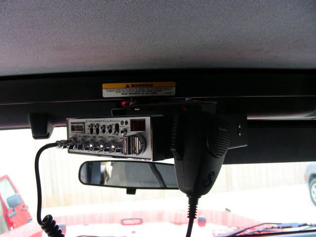

if you buy a small enough cb and a right angle adapter for the antenna cable you can mount it right to the plastic fairing above the rearview mirror, thats how mine has been for well over a year now and it works perfectly

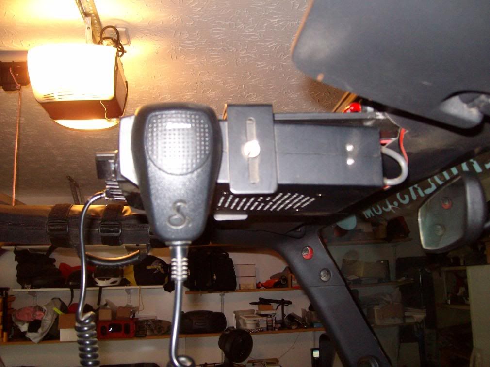

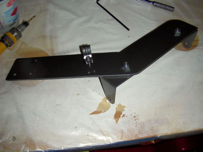

Here is my home made mount

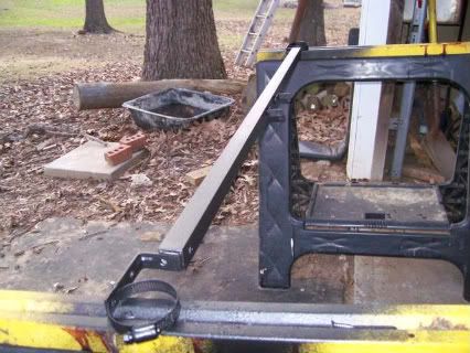

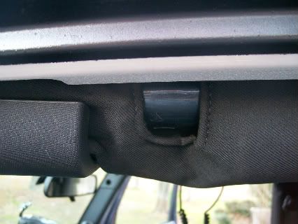

no drill cb mount

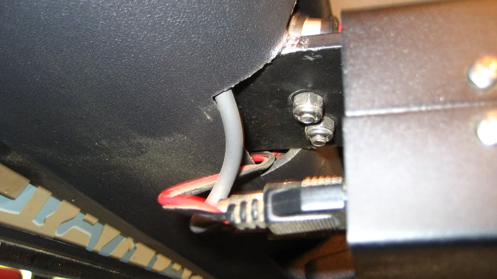

I took some aluminum tube, four 90* brackets, hose clamps, and can of duplicolor bed liner and made my own drill-free mount. I had all of it laying around minus the can of bed liner (which was more expensive than I remember it). It does not rattle, and required no holes in the Jeep or any other changes. Unscrew two hose clamps, unscrew the coax, and unplug the weatherproof quick disconnects I made and the hole assembly comes out. You can then stuff the wires in the plastic molding over the window.
I used two 90* brackets to mount the CB to the bar instead of the bracket it comes with so it would be tighter and closer to the bar:

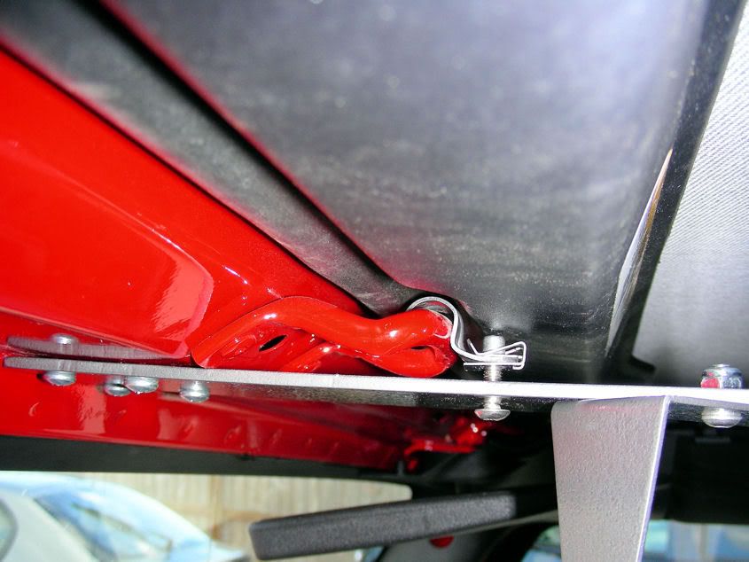

Here it is after being sprayed with bed liner(Left): ************* The clamps fit in front of the freedom panel alignment pins, the rollbar pads cover them(Right):
