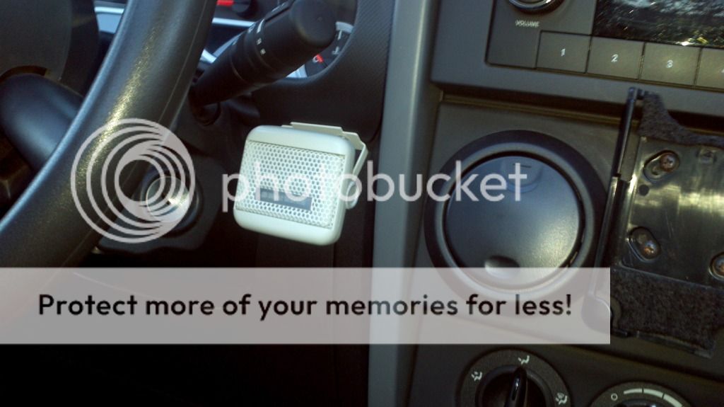

any of you guys have pics of your mounting locations? i am going to get a cb soon, l just can't decide which. i was wanting the cobra 75 til i read this thread, now i'm looking cobra 29 or uniden 720...decisions decisions
29 50th anv.

Originally Posted by JK Vick View Post
29 50th anv.
i'm kinda liking this spot as it seems most out of the way but easy to get to, did you make a bracket?
