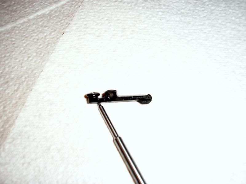

Hey experts,
I disassembled my AR this afternoon to clean it after shooting it for the first time yesterday and when I removed the extractor, I set it on the table while i was cleaning. When i picked it up and wiped it off, I dislodged the extractor spring and it fell out....no biggies, it fell on the table on the white t-shirt I was working on. So I picked it up and put it back in,,,,
I reassembled everything and think I got it back together right, but was looking at an exploded view a minute ago and noticed that mine was a little different....
I have a spring, and I have the little insert, but mine had a small o-ring around the spring and I don't see that on any exploded views I have looked at?
When I put it back togehter I placed the insert back in with the head of the insert in the hole of the extractor and pushed the spring (with the o-ring around it) back in to the hole. The o-ring does not go into the hole, it just sits on the outside of the spring??? Is the o-ring supposed to be there? It couldn't have gotten there any other way, but it does not show up in any pictures I see
I knew you would ask for pics, so here are a couple I just took

Its an LMT, and I can't figure out any way it could've gotten on the spring since its a tight fit and the odds of the spring falling right into that o-ring are pretty slim .
I just wanna make sure its supposed to be there even tho I can't figure any other way it would have gotten there unless it was placed there....Gun shot like a champ when I shot it yesterday, hopefully doc or one of the others will know sumpin,,,,

Your extractor is different from mine- looks different anyway in the pics. If the gun shot fine I wouldn't worry too much. If you have a gun smith near you check with them too. It's a tough question to answer without seeing it in person- for me anyway.

It's correct. Your Ar has the "upgraded" extractor spring kit meaning they added an o ring. If you don't like it, go to Wolf gunsprings and order one of their springs and you won't need an o ring and the extractor should perform flawlessly.

Some ar's have extraction problems due to weak extractor springs especially after slinging lots of lead down range and the bolt starts to get gunked up. So this was one of the solutions.

Looks right to me. I broke mine down last night to have a look and I have the same extractor. My AR is a Spikes Tactical. The extractor has the same oring and spring as yours.

You are good to go. That O ring is standard on all our exttractors at Spikes Tactical. Its an upgrade most shooters did to Ar's not equiped so from the factory. Just Like Staking the gas key was an armorers "upgrade" years back, most companies now are doing it factory direct. Most "upgrades" years back on ar-15s are now becoming "standard" from the factory.
That O ring is a wear Item so check it during cleaning and cheap insurance keep a couple on hand as spares.
