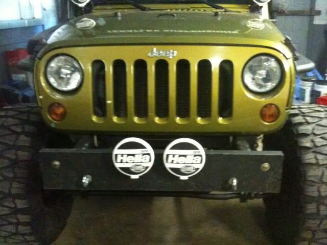

installed them tonight, woulda been super easy and quick IF they fit properly
According to the instructions:
pull your grill
remove the 4 torx screws, pull the ring and your headlight - unplug it and set it aside
plug in the wiring adapter
now here's the funky part, instrux say you don't use the ring anymore, but without it nothing holds the lights in, with it they fit just a bit loose, maybe a millimeter of play
so I found an old piece of rubber hose from a boost gauge, ringed the inside of the retaining ring with it and screwed them on and they hold good and tight.
I just hate having to rig new parts

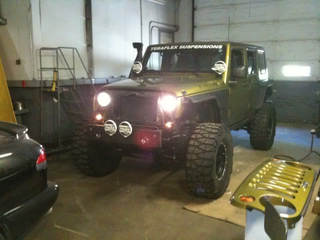

HOWEVER, functionally, they rock.
Much better light output than stock, glass so they don't scratch like stock and the don't dome out so it's easier to pull the grill and fit it between the lights and the grill hoop, plus the variety of H4 bulbs available.
here are a buttload of pics.
Probably not needed, its a simple install but the camera was close

It is pretty amazing how much better they work, low beam on these seems to illuminate the road about as well as high beam did in my stockers with silverstar bulbs, yet they are still focused right and don't blind oncoming cars- at least I haven't been flashed *yet*, and high beam is actually useful for something other than making reflectors glow a little farther ahead.
Definitely a good use of $100

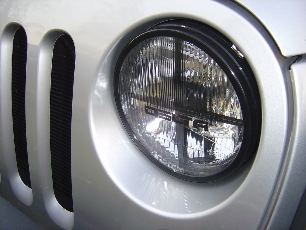

Well I want to first say, More often then not.. Our large distributers have the wrong image for the wrong part. this is something I'm personally em working on with them.
second,
I don't want to place all the blame on or distributer. We also made a mistake here. It doesn't happen often but we are all human & its bound to happen every once & a great while. The INSTRUCTIONS given in the box were for our JK Quad-bars head lights... Venom should of received 01-1148-50x (Jk replacement headlights) instructions..
third, when We make a mistake, here at Delta we'd like to make it right. I personally emailed Venom, telling him he should of received two silicone gaskets in the box. this being said We will be mailing him the 2 gaskets to make the factory JK bezel fit right.
below I have attached a image of the Quad-Bar head lights

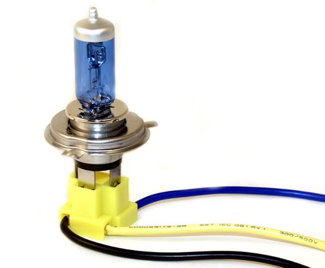

BULBS
Originally Posted by John L View Post
Venom, if you get a chance, you have to try out Osram #64205. It's a 70/65w, they kick some serious light out. Only about 22 per bulb. They don't last as long, but I think they're worth it.
Well not to talk bad about anyone else's product but I thought you should know...
the Osram 70/65w H4 is a Halogen bulb.
this being said.. the NEW technology Xenon Bulbs is a different type of gas inside the bulb allowing the light to burn hotter... hotter = 30% brighter
the bulb Venon has is a 60/55w (DOT)
*FOR OFF-ROAD USE ONLY*
we also have a 100/80 watt & 130/90w
Delta Lights is offline

the quad bars have the metal cross braces inside, behind the glass
the others don't
